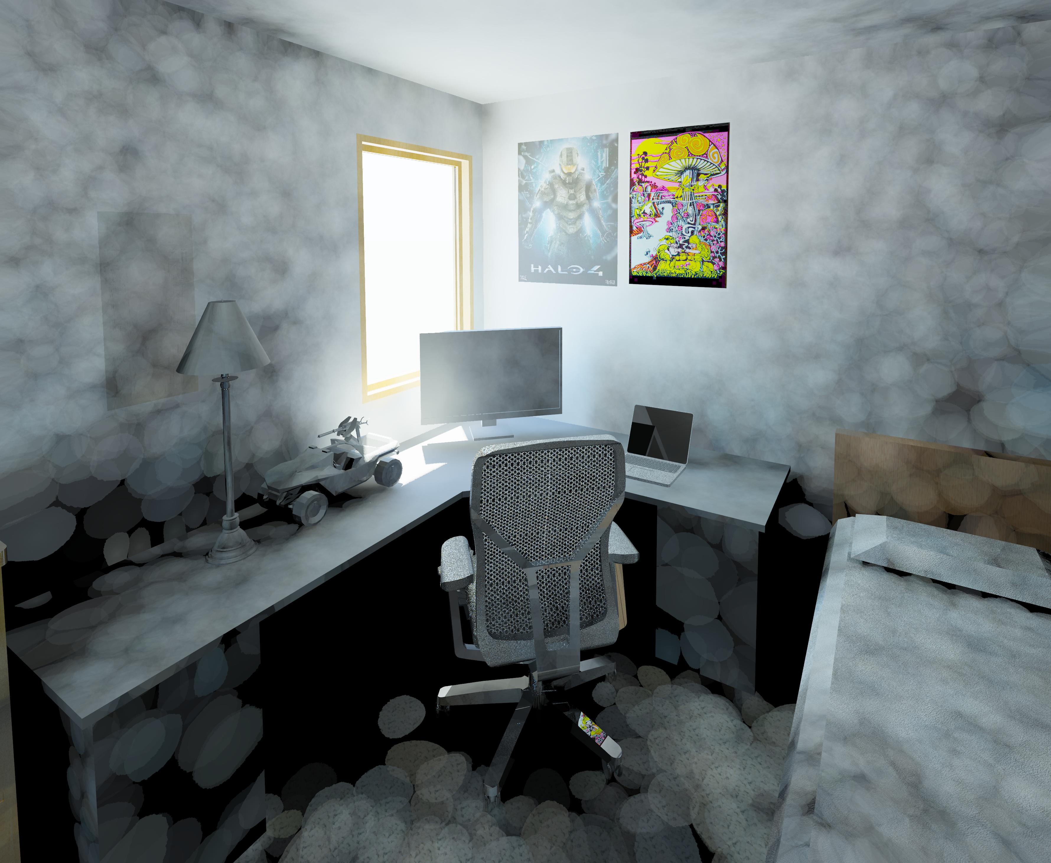

Here is a render of something I did, I hope I can learn how to get this picture 10x more clear in the future.

Im not sure where you think Revit is lacking?  Revit is leagues ahead of AutoCAD and once you learn how to use all of the powers of Revit you will never want to look back at AutoCAD.  If that was your first rendering ever its not to bad, if not you need a lot of work.  It looks like you didn't apply materials to any of your families.

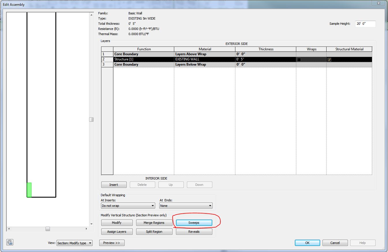

"Im not sure where you think Revit is lacking?" - one particular thing I can think of is moving walls. For some reason I haven't found a top or bottom plate feature that is associated with walls. Iv talked to some co-workers and they say they use detail lines to draw in the different pieces of wood. So when I move a wall, I have to change every section going through that wall? Which leads me right back to the same thing as regular autocad. Execpt now I have to remember what little things do not update and which do? I dont think this is the right way to do this. What would you suggest?
This wasn't my first rendering, I have dopped cameras into rooms and pressed the render button but this is the first project that I am starting to create the 3d objects from scatch/ download from this website. I created them in autocad and then "linked" them into revit. So i was not sure how to apply revit materials to the indiviual parts of the autocad 3d dwg. I did apply a wood material to the top of the desk but the "link" from autocad to revit was not working.

You still have a lot to learn.  You can add a sweep to a wall type that would be your top/bottom plate.  You could also actually add the top and bottom plate using a family and assign it to the correct level, if the level changes it will automatically change with it.  This could also be done as an in-place family.
