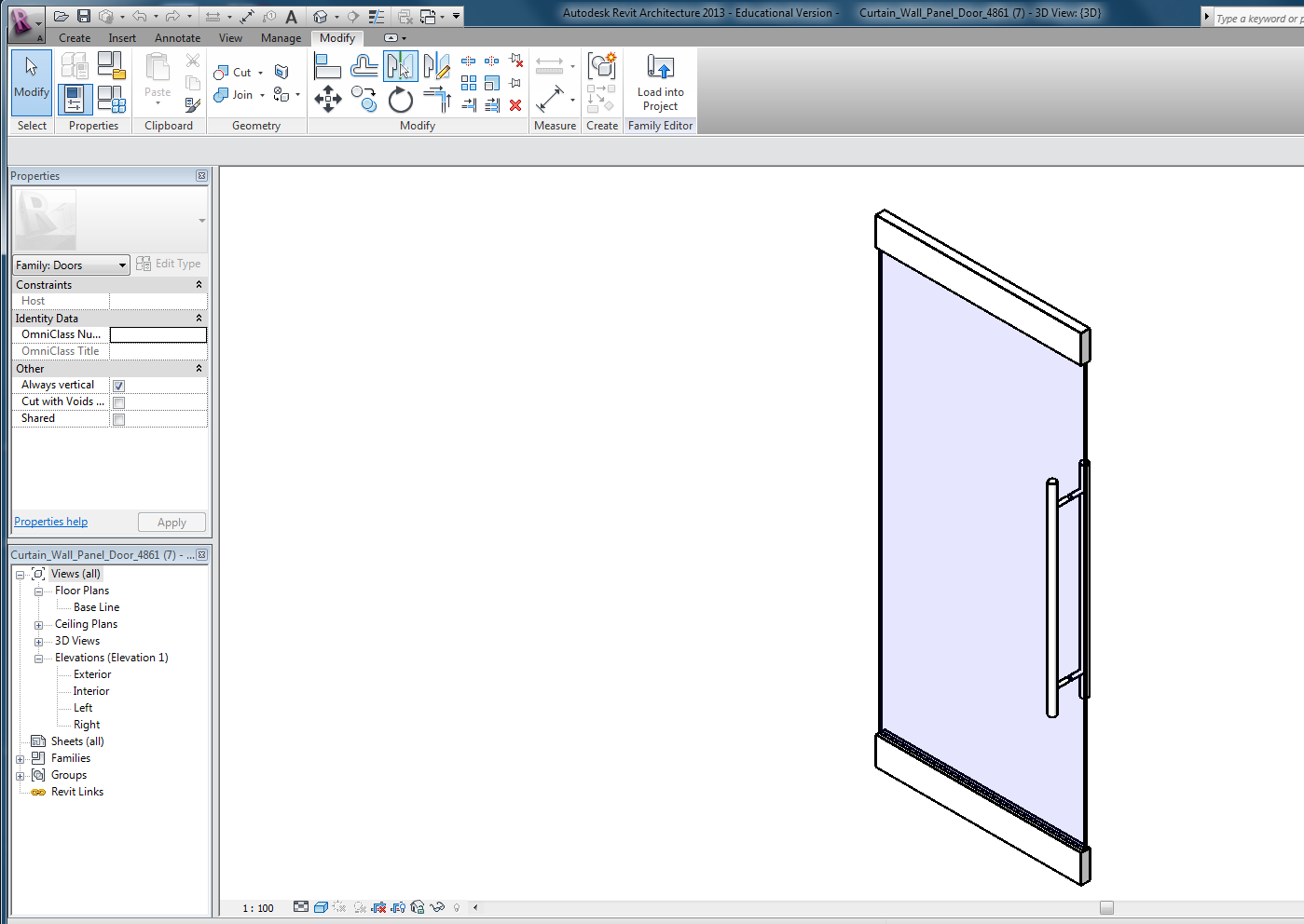

Every time i try to load in somthing for the files or load in something from revit city it never show up and i was wondering what im doing wrong or how to fix it?

i have downloaded it and had it open but when I press the load into project button it never show up in the project. That what i need help with.

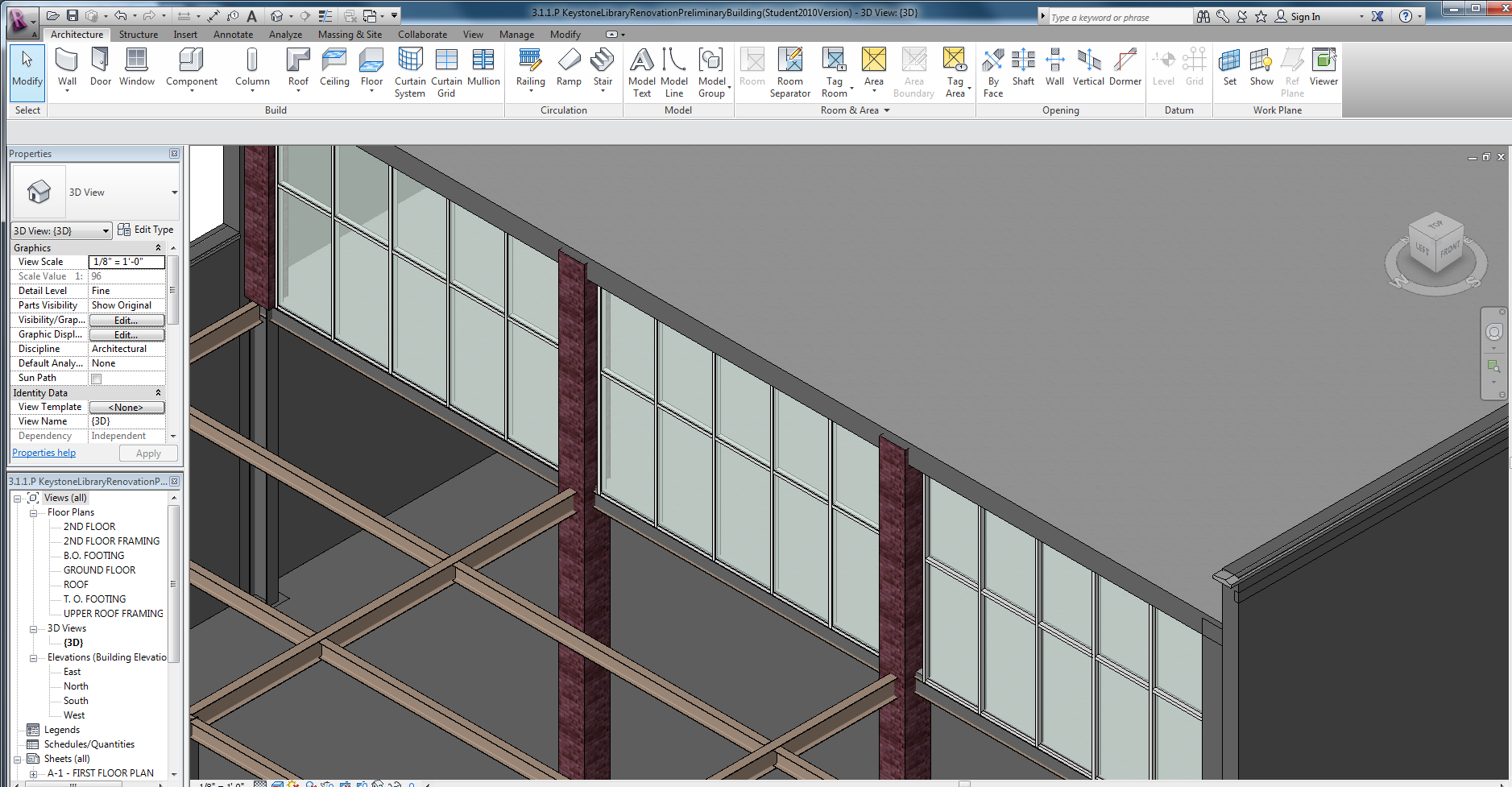

I found the faimlly and when i click load into project it close out of the faimilly and goes to my projuct but it never showes up. the second picture is what it look like after I click the load in to project when the object doesnt show.
Tue, Apr 8, 2014 at 10:46:21 AM | the load in family not working
Well did you actually place it????   Revit can't guess as to where you want it.  This is a curtainwall door and you have to swap out a curtainwall panel with this.
Please - please - read your HELP - Curtain walls.

I would place it if it would show up for me to place. i have loaded in thing before with no problem.

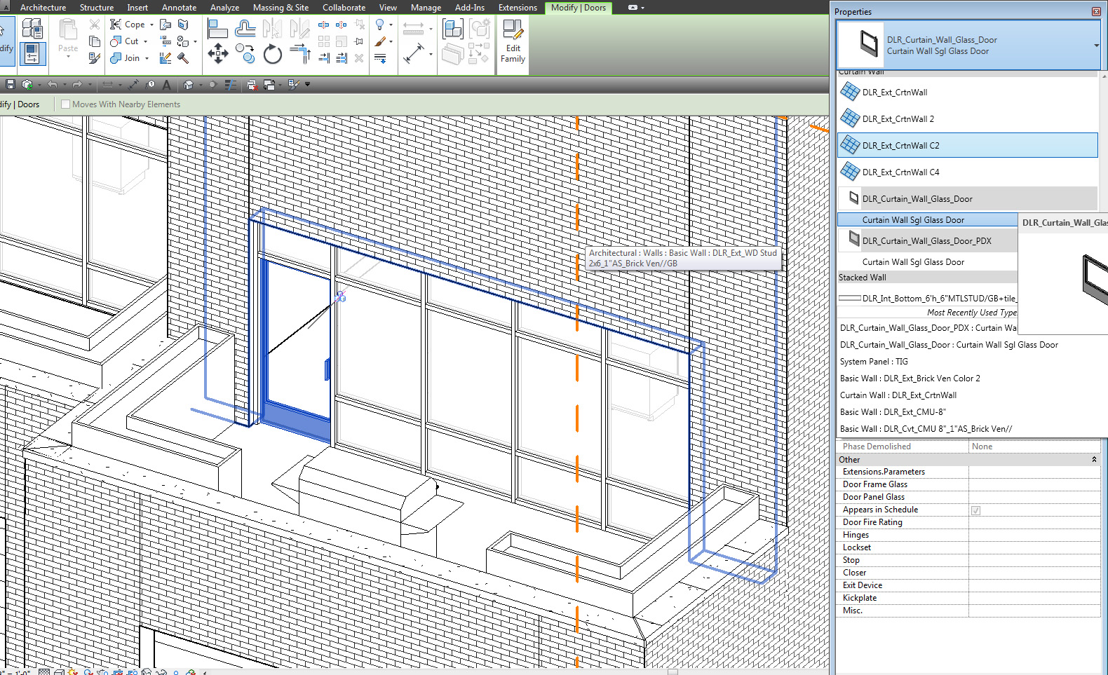

You need read our responses better.  You need to click on the curtain wall panel that you want to change and in the type selector pulldown change it from the Glazing to your Door
This is a process problem not a Revit problem.  As WWHub said you should read up in your help on curtain walls and learn how they work so that you know how to change the panels, mullions etc.

If the door you are looking to place is part of a curtain wall family, then you most likely have loaded it in the project.  However, those types of doors will not show up right away.  Here is what you have to do:  Click on the curtain wall glass panel where you want the door to be, unpin it and then swap it using the type properties menu pulldown.  Your new door should appear in that pulldown menu.
It is that easy.

Thanks that work
