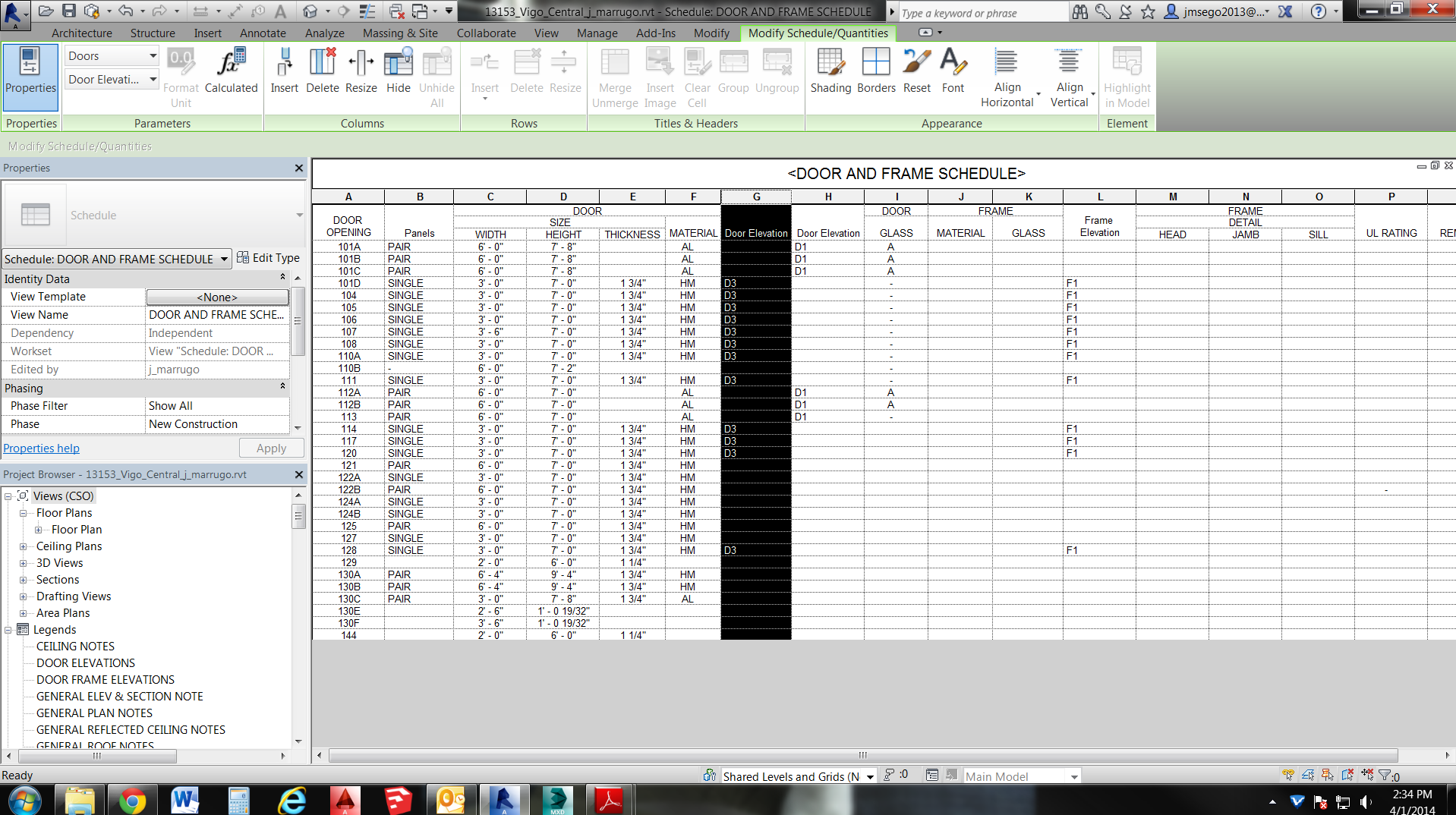

Hello,
I am using Revit 2014.  I am creating a door schedule and some of my door elevation and frame elevation tags are showing up in the door schedule and some aren't.  I have been messing around with shared parameters, but still can't get it to work.  How do you get the frame and door elevation type to show up in the schedule?
Thank you!

Thanks for the reply.  The parameter is loaded in both my project and my families, but still is not appearing correctly in the schedule (see atttached).  I have no idea how I ended up with two columns now.  If I go into the family, the Door and Frame Elevation is loaded under the Constrction parameter, but they still are in two separate columns?
Tue, Apr 1, 2014 at 1:49:05 PM | Problem with Door Schedule
No - the schedule is working correctly - You are not understanding.  I am trying to point out all the possible variables and you are not seeing two of them.  Type vs instance.
Look at at door that you say schedules correctly.  Where does your parameter show up, in the instance properties section or is it in the type properties section?  Now look at your door that doesn't schedule right.  I will bet you find it is using the wrong parameter.
