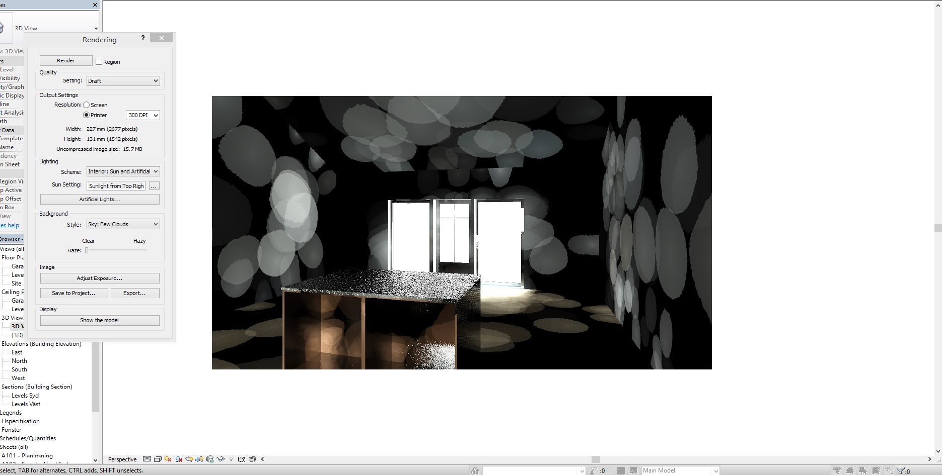

Hello there!
I'm pretty new here at RC and have tried to search for a answer for my question but failed,so i hope someone out there can help me out!   I have tried to render some test indoor pictures but always when i do, it looks like a cool 90-s disco is going on in my house!And thats not with purpose!   When i render outside it's always clean and fine! And i have tried to put lights inside but the only thing that happened was that it looked a little bit brighter.
Is it someone who had the same problem or maybe know whats my disco problem can depends on?

The dico look is reflection of the exterior sun off all your shiny interior objects.  Either turn off the exterior and only use the interior lights or really up the output of your interior lighting.
