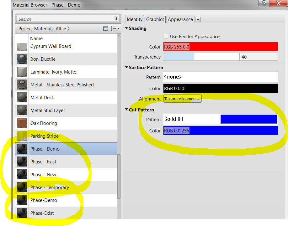

Good Morning.
When I demolish a wall while working in hidden line view, everything appears as I want it to: the walls chosen to be
demolished become dashed. When I switch to a shaded view, the demolished walls have a solid blue hatch that I cannot
seem to get rid of. I have tried using phase filter graphical overides to no avail.
The end result I am looking for is the demolished walls to show dashed while remaining walls maintain their shaded look
(which is why I am working in a shaded view).
Any thoughts or help would be much appreciated.
Thank you.
Mon, Apr 28, 2014 at 5:43:36 PM | Demolition with Shaded Visual Style Revit 2014
dgcad
dgcad Avatar
Joined: Thu, Mar 17, 2005
1231 Posts
3.5 Stars: 36 Votes

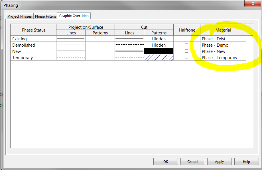

I have afishy suspiscion it's being controlled by the 'material' beining specified in the Phase Filter Overides.
See image attached.
Mon, Apr 28, 2014 at 5:46:30 PM | Demolition with Shaded Visual Style Revit 2014
dgcad
dgcad Avatar
1231 Posts
3.5 Stars: 36 Votes
Image # 2 . . .
