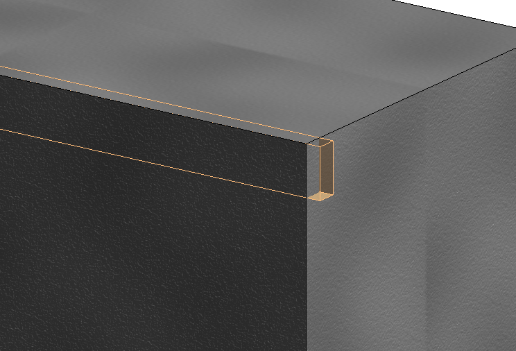

Is there a way to make a line based wall rebate family (please see attachment) that cuts the wall when loaded in the project ? Ive made a line based void family but i cannot get the family to cut the wall when loaded in the project.

Why are you not simply using the wall reveal tool with that profile?
Don't complicate this.

because i want the rebate to show around a door opening. You cant you the reveal tool to do that
Fri, Mar 28, 2014 at 8:47:48 AM | Line Based Wall Rebate Family Question ?
Then just do an in-place (void) sweep and sketch the path .... again using that profile.  Forget the line based in this instance.

yea im trying to get away from doing in-place families everywhere as it is a very big project and i just wanted know if it could be done by making some kind of family ???
Fri, Mar 28, 2014 at 12:45:29 PM | Line Based Wall Rebate Family Question ?
You can create a face based family just like your in-place family that is a void sweep (or extrusion) that cuts the host....  Use the face based template.  Create the void sweep and set it to cut (pick) the host in the family editor.  You can add parametric controls to this.
