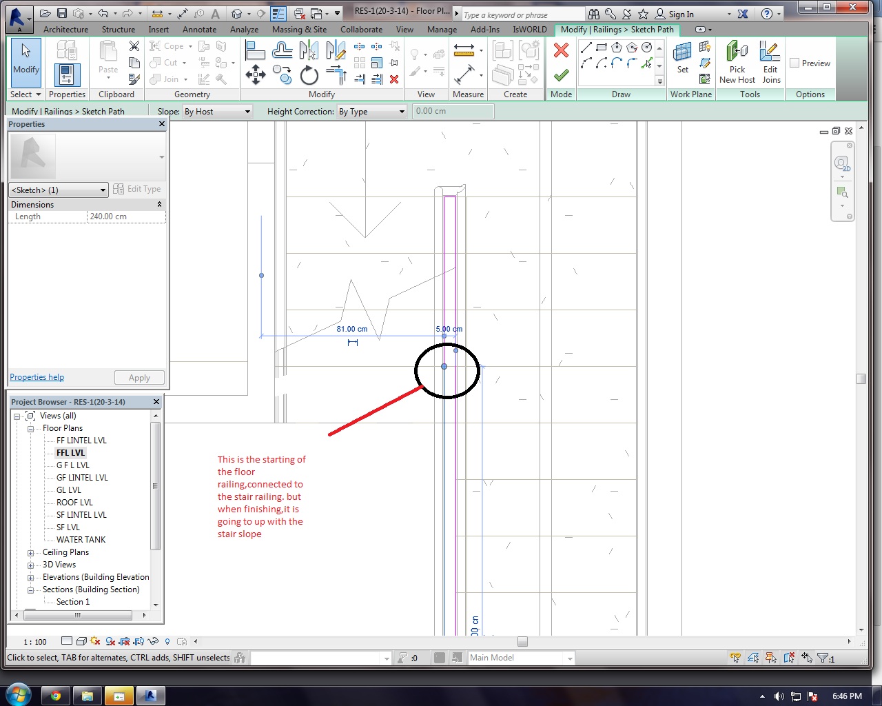

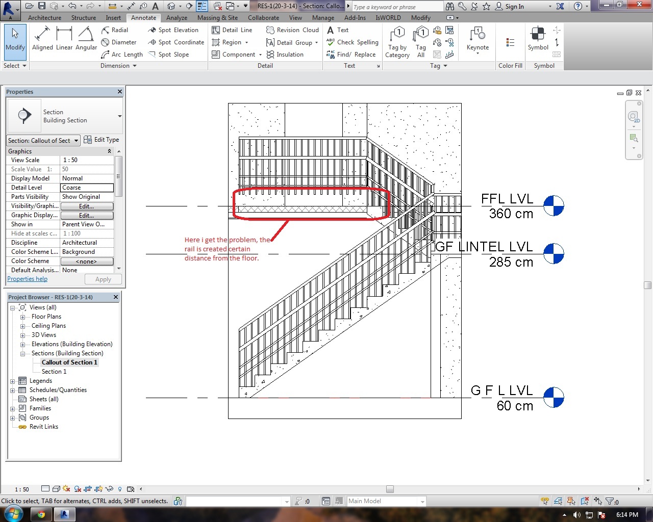

hi every one, while am creating stair from ground floor to first floor, i need the stair railing to be extent to the floor, but i cant railing properly on my floor, it is created above the surface with some offset. please give me a solution. here am attaching the scrren shots

Your problem is you ended your stair with a tread.  Edit your handrail sketch and pull the intersection of the slope/flat back to the last riser.

But it is not coming properly, please find the attched picture

I don't think so.... Delete the portion of the sketch that is the flat.  Then see what happens.  The extent of the rail is only the sketch.  It will not go on up as you say.
