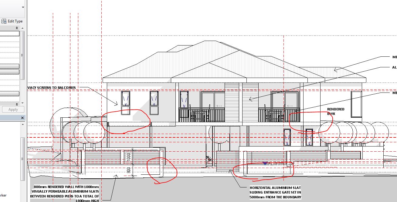

Hi Guys,
Just a quick one from a newbie, and forgive me if I am postin gin the wrong area..
I have created two storey building with the slab edge between the ground and first floors (image attached). However in elevation the line is visible, when in fact, once rendered the line ideally would not be shown here. I'm sure this is very basic but appreciate any response.
Cheers
Tim
Tue, Mar 25, 2014 at 10:11:16 AM | Lines of components visible?
If the slab extends to the exterior face, then the slab (line) will be visible.  Correct that.
3d components show contour lines in plan view.
