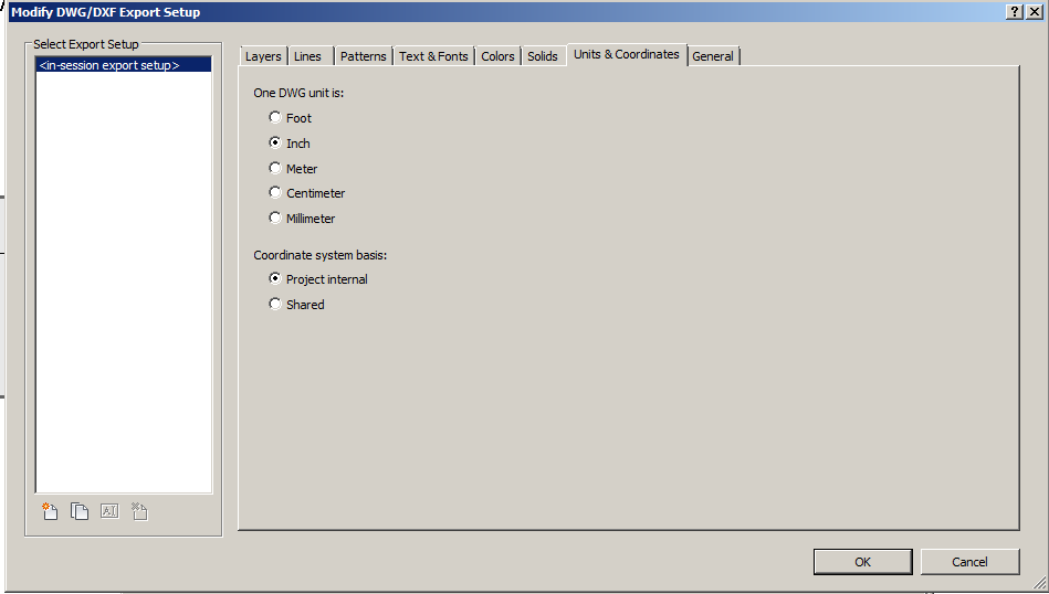

Hey! I use Revit 2014 and I'm having problems while exporting to dwg in the right scale.
I set to export in METERS, and in Autocad, the Model part is inthe right scale.
But when i go to LAYOUT, in the exported CAD file, its too smal.
Is there any way I can set to both MODEL and LAYOUT be exported in the right scale?
Thanks.

Yes, I set it to export in Meters.
I expected it to be automatic, but ONLY the sheet is exported in the wrong scale. I think it is 1000x smaller.
But inthe model part everything is ok. i really dont know what to do.

I'm not sure what you are doing.  When I export a file whether it be a view or several views on a sheet, they open correctly in CAD.  Perhaps someone has messed with your standards for export.  See attached.
Remember.... In revit, everything is 1/1 in views.  That's why we use sheets.

Hello, Hola, Hallo
There is abundant text in the internet for this issue... very extens... so I solved my problem relatively easy (after reading and reading forums and sites)
My problem was: I exported my revit sheets to dwg.  In autocad is draw in mm. everything is 1000x largest. so...
1-R-export-options (last down button)-export setups for dwg/dwf-units and coordinates tab-one dwg  units is... set your unit!
2-export views or sheets
I hope this problem is solved
