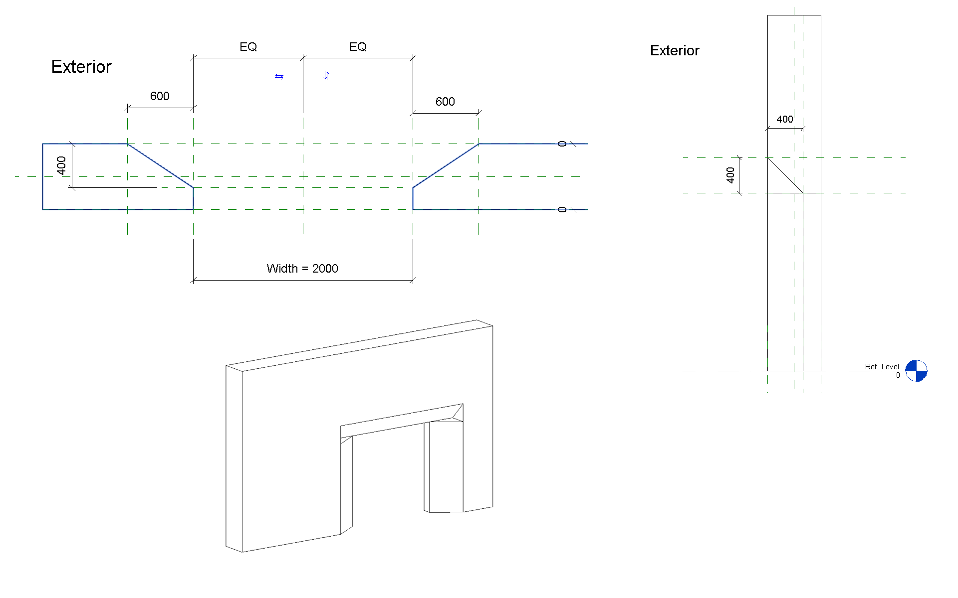

I have to make a wall opening with chamfered(?) corners (attached file "rp1"). I would like to have the opening parametric, since I will have to use it on my model more than once, but with different opening width and height.

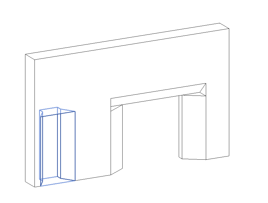

I tried to create a new door family, made the opening with void extrusion and I chamfered corners with void sweep. Problem is that sweep profile (trinagle) is not the same on sides and on top of the opening (on sides is right triangle with sides 60cmx40cm, and on top is isosceles triangle with two sides of 40cm). Attached is result :-P

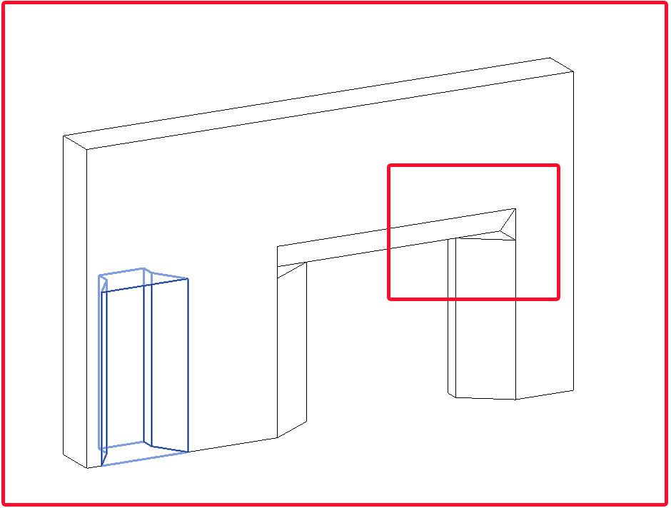

Will using different template solve my problem with meeting void sweeps that have different profile (see attached image)?
Fri, Mar 21, 2014 at 10:47:40 AM | Introduction / wall irregular shaped opening
I see your image but it has no meaning.  If that's not what you wanted then your procee is wrong but you don't tell us what you want.  If you want the sweep to turn the corner...(miter)... then it needs to be one sweep - not 3.   ONE PATH.
Fri, Mar 21, 2014 at 11:17:50 AM | Introduction / wall irregular shaped opening
VedranV
Joined: Wed, Jun 12, 2013
0 Posts
Yes, I would like that sweep turn the corner, but can not do that by defining just one path because top sweep void profile is not the same as side sweep void profile. The top sweep void profile is right triangle with two sides of 40cm (isosceles triangle), and the side sweep void profile is a right triangle with sides 40cm + 60cm + hyp.
Fri, Mar 21, 2014 at 12:22:13 PM | Introduction / wall irregular shaped opening
Then don't do it as a sweep!  Do it in segments....

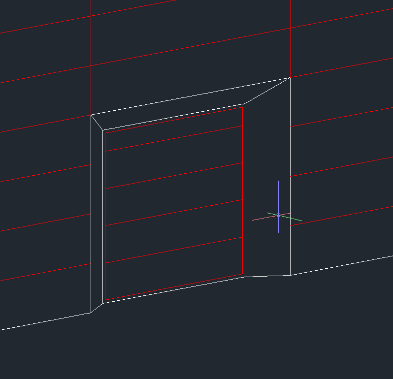

A user from other Revit forum helped me with my problem. He used door based family, but instead of using voids to cut the wall, he built out he masses.
I customised his revit door family with my parameters. Attached is one of probably many solutions to my problem.
