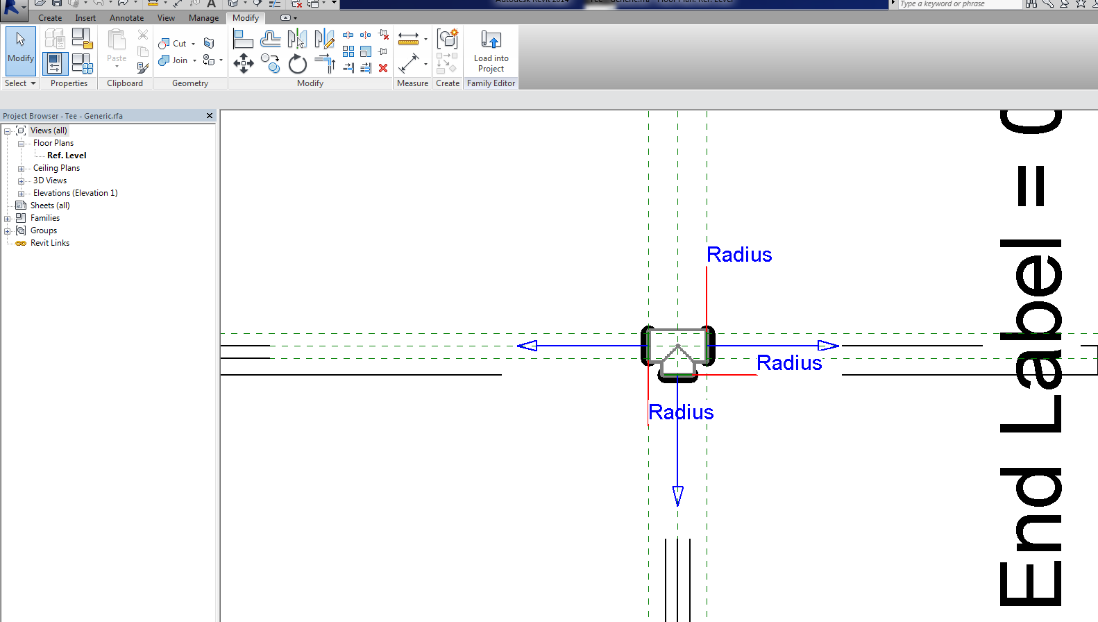

This is what i am looking at.

Thu, Mar 20, 2014 at 4:19:19 PM | How to get pipe fittings to appear as simple pipe lines?
#10
Johnzo142
Joined: Fri, May 8, 2009
47 Posts
Hover over the heavy black lines and hit tab until you are able to select it, then delete it.
Thu, Mar 20, 2014 at 4:22:16 PM | How to get pipe fittings to appear as simple pipe lines?
#11
SWILLBILLY
Joined: Tue, Mar 4, 2014
0 Posts
AHHHHHH Thank you Soooo much!!! And thank you for for responding so quickly.
