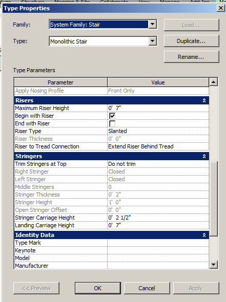

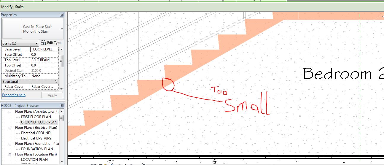

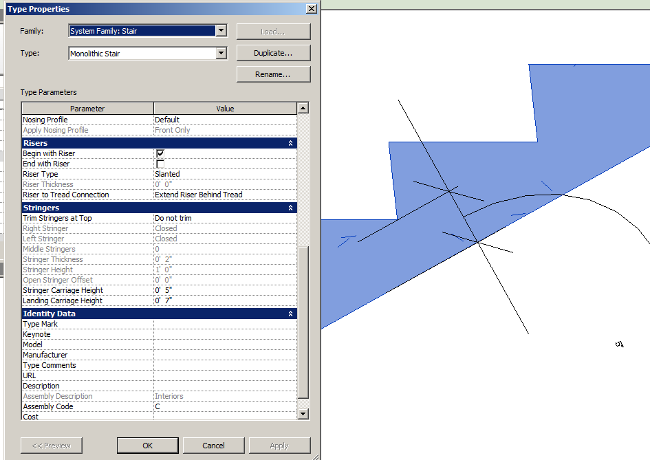

I have been trying to to increase the size of a stairs treads depth,
Currently it not pass any code test.
Please provide feedback
Thank you
*Attached image
Thu, Mar 20, 2014 at 3:24:55 PM | Stairs Depth
Edit the type properties - stringer carriage height

Thu, Mar 20, 2014 at 8:40:31 PM | Stairs Depth
mansell5
Joined: Sun, Jun 14, 2009
68 Posts
3.5 Stars: 4 Votes
reduce tread depth to 275mm , see if that makes a difference
Fri, Mar 21, 2014 at 7:08:52 AM | Stairs Depth
DAMAREVIT ....  Come on.... Do you see that slider on the right of your image?   Pull it down!  The settings are below what you show.

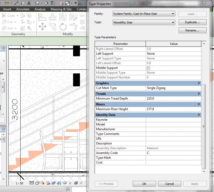

Trust me, 225mm never changed anything, I am really wondering what could be the issue.

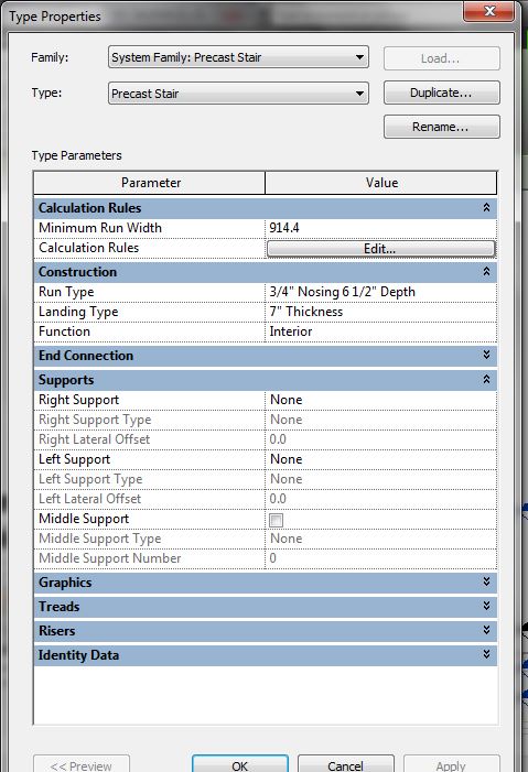

Fri, Mar 21, 2014 at 9:06:15 AM | Stairs Depth
DAMAREVIT
Joined: Wed, Dec 12, 2012
0 Posts
wwhub, ok let me follow you, I think in 2013 those options are not in the type property box, what I just did was change the stairs type from monolithic to precast, and now the depth as been increase which is good. I still need to figure out how to increase the depth by using the properties box. What version revit you are using?
Fri, Mar 21, 2014 at 9:32:21 AM | Stairs Depth
#9
Balony.... I've been using Revit since 8.1 and I have 11,12,13 and 14 installed now.  Use the slider on the right of the properties box that you posted to slide down.  If the chevron on the right of the blue colored bars points down, click on it to expand that area.

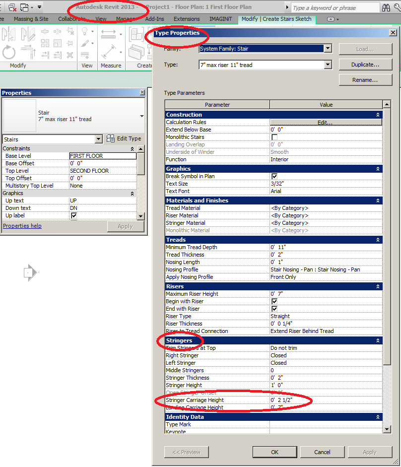

Oh, yes... i did slide it down and all that and all i see was identity  data and those kind of information, could you post an image from within 2013 with the option you telling me to find,
thanks

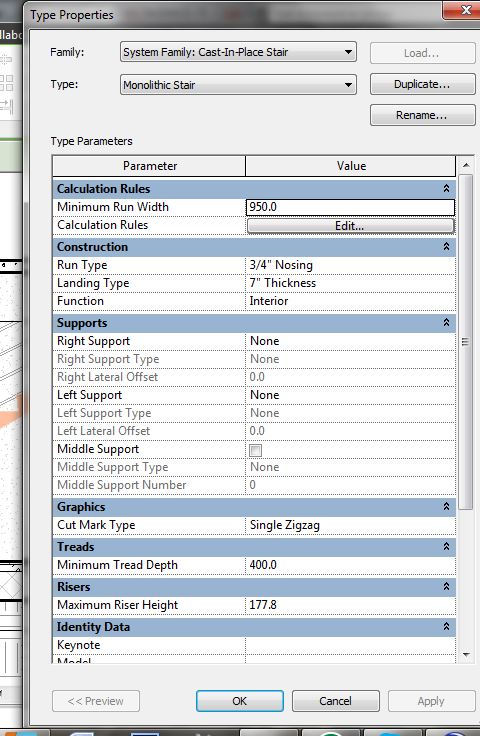

Fri, Mar 21, 2014 at 9:48:36 AM | Stairs Depth
#11
Here
Fri, Mar 21, 2014 at 9:59:51 AM | Stairs Depth

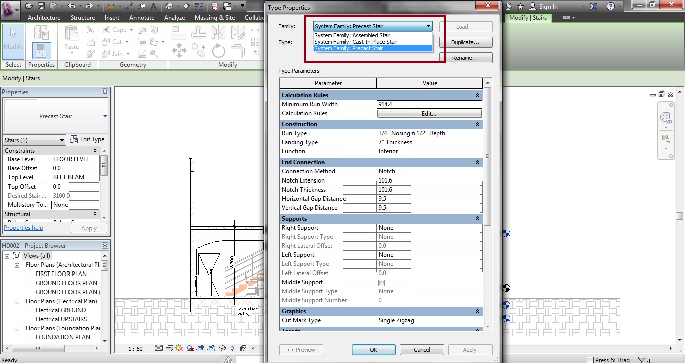

DAMAREVIT
0 Posts
oh, I see, your system family is stairs while i dont have that feature, something is really going on. atleast I find a work around.
Look at my image
Fri, Mar 21, 2014 at 10:05:33 AM | Stairs Depth
#13
What do you mean you don't have that feature...... You do....ALL STAIRS ARE SYSTEM !  And you can have multiple defined types.  I just pulled up the first one ... I also have the default Monolithic which yours has been renamed as Cast-in-plcae .... ALL THE SAME!
PLEASE-PLEASe-PLEASE pull down and expand the stringer category!

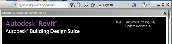

Fri, Mar 21, 2014 at 10:39:51 AM | Stairs Depth
#15
We have asked all users to include their Revit issue and updates.  This would have been settled long before now if you had done that.  You image shows me you have failed to install your updates..... And every issue has a different number of updates that must be installed in sequence.  2013 has 3.
