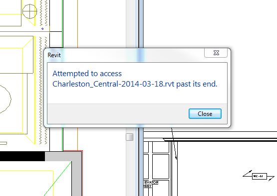

been having issue with this one central file.
was trying to save to synchronize, I recieve a message saying that my central file is past its end.
What the heck is that? and what am i suppose to do.
Any help.
Using Revit 2014

This thread should help you.  Apparently that is not a good error.
http://www.revitcity.com/forums.php?action=viewthread&thread_id=6418
Thu, Mar 20, 2014 at 2:28:30 PM | can not save a central file
Mr Spot wrote this a long time ago "...
Unfortunately "past its end" is one of the worst errors you can come across.
Contact Autodesk support and see if they can repair the file, but most likely it will be unrepairable.  Best bet is to find a local file or a backup that you can open that has the least missing information...." and create a new central
