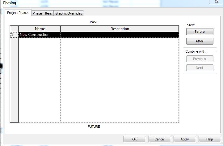

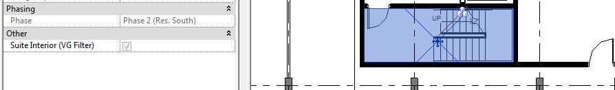

Hi I attached 2 jpg.
One showing it say phases is phase 2 (res. south)
The other is the phases option.
Showing just new construction.
It still exists.
Thu, Mar 20, 2014 at 12:57:11 PM | Ghost Phases
Well then we can't help you.  You didn't tell us how you altered your project and it sounds like you didn't do it according to how the HELP says to do it.  You said "... the team has already got rid of the phase a different way...."   We don't have a clue as to what they may have done.

HI
So there is 2 design options. Both of which do not have any of the elements in them.
ok so...
on the view when I change the phase to new construction the old one disapears from the options to put it back onto the old phase. And you can't change it back unless you undo everything.
This also happens when I change the schedule showing all the rooms that are in the phase to new construction.
When I try and change the room phase it is greyed out to saying the old phase is still there.
So all I want to do is take those rooms that are in the old phase move them to the new construction phase
