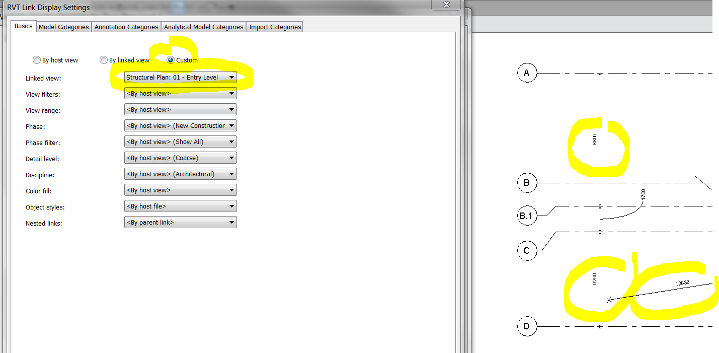

Pls kindly help meI have 3 revit file. Let’s call them:
File 1(Unit)
File 2(Level)
File 3(Block)
File 1(Unit) is LINK INTO File 2(Level). File 1(Unit) is set to attachment under manage link. Then I did some dimension in File 2(Level). Some of the dimensions are dimension to the element in File 1(Unit).After that I link File2(Level) into File 3(Block). File 2(Level) is set to attachment as well.
Then I go to VV, Revit link and change display setting to the correct plans which I dimension in File2(Level).Now the thing is, all the dimension I did in File2(Level) is not showing up?Below is the link of a similar problem but the poster managed to solve it. I swear I tried all that I know of and search everywhere but I still can’t find a solution.

I was able to get this to work. In a floor plan go into visibility graphics overrides, then REVIT Links, then Display Settings> Custom and set the Linked View to the view in the linked model that has the dimensions.
Your current view will need to be looking the same direction as the linked view with the annotations.
The drawing on the right side of the attached image is a linked model.

Thanks for the reply. But i did what you mention. But what i am facing is that ( I link file 1 into file 2. And i did my dimension in file 2 with reference to file 1. After that i link file 2 into file 3 and i went to VV, Revit link and change the view to what should be shown in what i did in file 2 but the dimension is not showing up. Those dimension that i did in file 2 is not showing in file 3 when i change the VV, revit link view.
Hope you understand what i am trying to do here.

There is no solution to 'the problem' other then correcting your process.
First - don't link files when they really should be in one file.
You typically always want to document (annotate) in the file you will print from.   Dgcad gave you a way to link a view but that is all that is - a view from the linked file and will be exactly what that view was.  You can add your own dimensions to this view and any added model elements that are in your file can be tagged or edited but you can change anything in the linked view.
