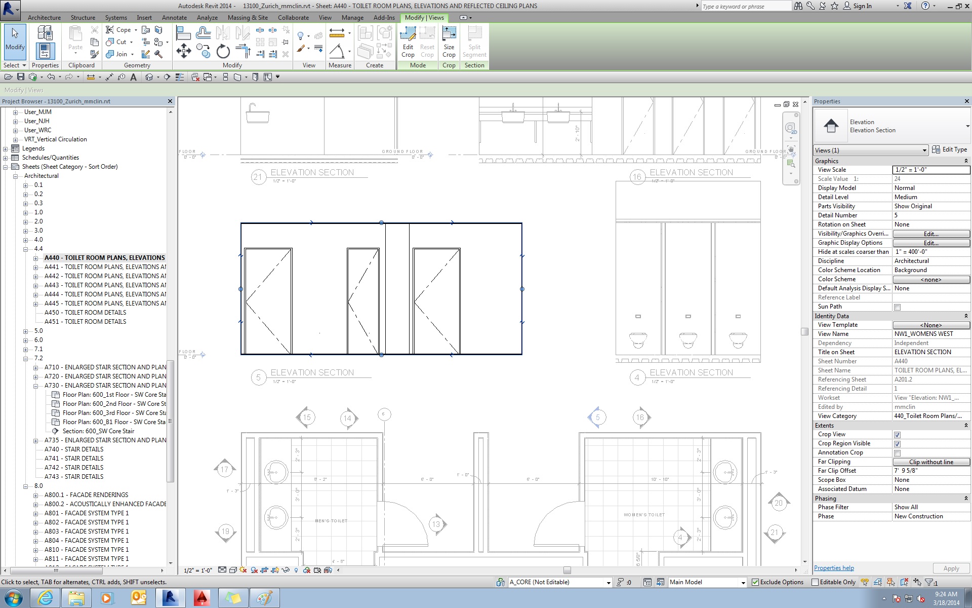

Obviously I wouldn't have resorted to masking regions if I were able to edit the view boundary. That's the problem, though. I can't edit any of the view boundaries (except for that one elevation).
None of my views are pinned and all of them have the "Crop Region Visible" option checked.
I've attached a couple screenshots. Elevation 5 is the only interior elevation where I can see and edit the view boundary. I was able to change the visibility on that boundary to a thicker line, which is my desired effect. On Elevation 4, all of the properties appear to be the same as those on Elevation 5, but I cannot see nor edit the view boundary, which is why I resorted to masking regions. Any idea why it's not showing up?

Please show us an image where you click on the boundry of elevation 4.   Properties says you are not showing that.  When you do it will say views(1) under properties.

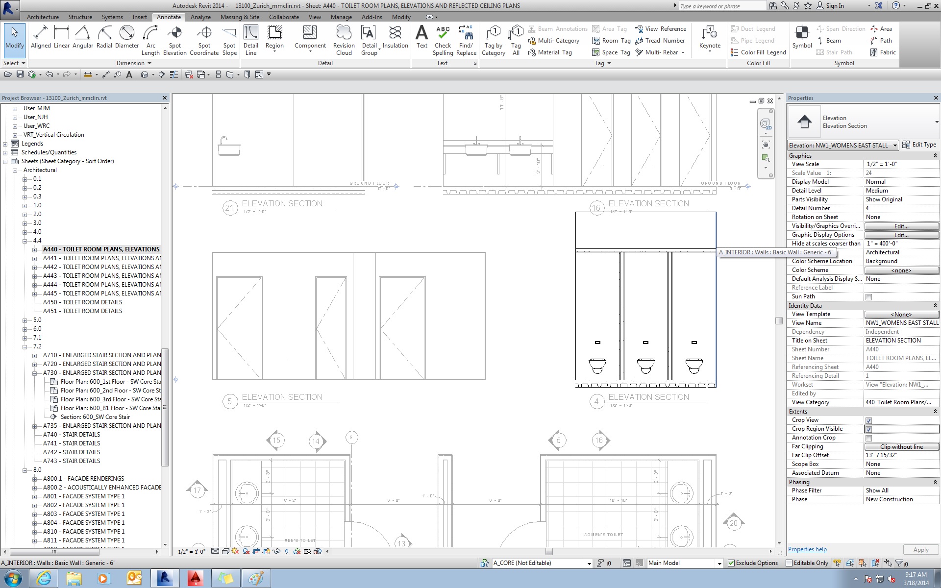

One quick comment on Elevation 4: We originally had higher ceilings in this room, but have now lowered them. I had made this elevation back when the ceiling was higher, which is why the view region goes past the lowered ceiling.

I can't select the view boundary on ELevation 4. When I hover the mouse over where the boundary should be it selects the wall (as shown in the image). When I hit the Tab button to cycle through other nearby objects, it still doesn't give me the viewport as an option to select. It just cycles through the wall, chain of walls and room boundary.
It's like the view boundary has been hidden somehow, but I have no idea how or where it could have gone.

Every once in awhile, I have seen a view become corrupted but it is rare.  I can't reproduce any instance to create the problem you are having.
Cut a new view.  You can copy/paste all annotative elements view to view.  If it was corrupted, then this will fix that.

Looks like that works!!!! I made a new view of an existing elevation and I can edit the view boundary of that view! That's crazy that none of the others had worked, though.
There's a small team working on this model with and my primary focus has been these core rooms. So far no one on the team has claimed to have manipulated any of the cores or anything on the 'CORE' workset.
I did make most (if not all) of these elevation views in one day. Perhaps Revit was having a bad day that day? Let me know if there's any other info you'd need to pinpoint this error.
In the meantime, I'll start re-cutting these views since that appears to be working. Thanks!!!
