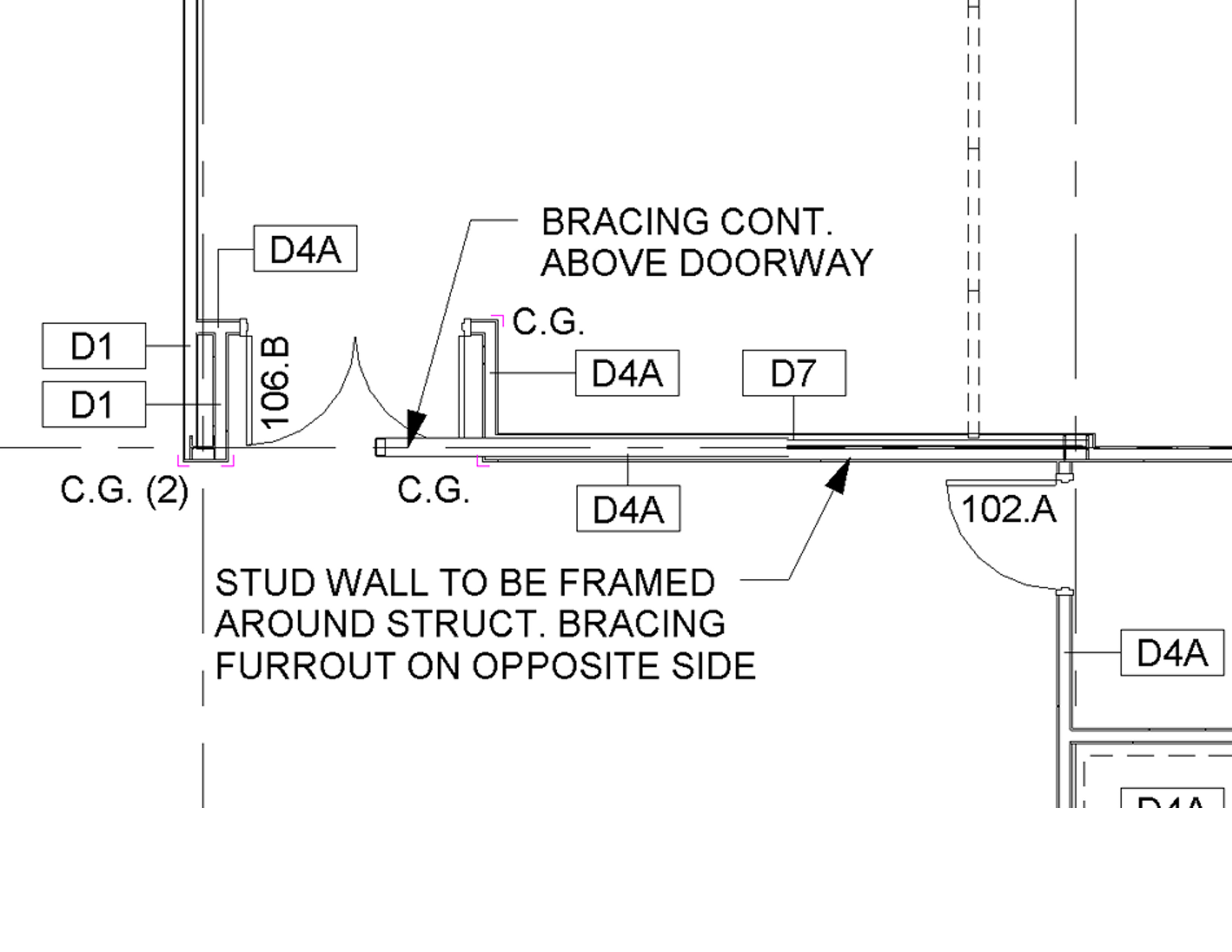

I have a structural model linked into the architectural model. The cross bracing from the structural model is showing up in my door ways. I have tried plan regions to change the cut and it hasn't worked. I have tried changing the view range in the structural model to match the architectural modal also. Any suggestion on how to correct this so we don't get commits about our structure being in our doors?

Learn to control your linked models through their own VG settings.  VG/LINKED REVIT/CUSTOM/....now you see the linked model VG where you can turn this category off.

I don't want them turned off, I just want them to cut with the cut plane so they aren't in the doors. I found this post and am trying to fig it out...
http://www.revitcity.com/forums.php?action=viewthread&thread_id=31478
