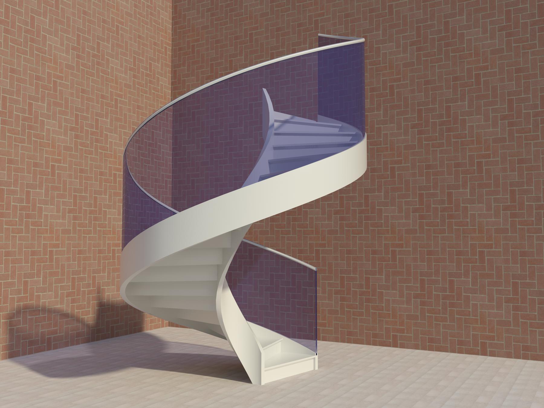

I am a student in need of help. I'm trying to make a modern house, but I need a spiral staircase with an all glass handrailing. If anyone could take me step-by-step, that would be great!
Thanks-
Q
P.S. I tried to follow other guides and got confused, I want something like the picture inlcuded.

you could remove all handrailing and have 900mm high balusters with no spacing between, this would achieve the effect

Do you have the chance of using revit 2014 instead? We have modeled a few spiral stairs by component (not by sketch) using revit 2014 and as long as the stair is not more than 360 degrees it should be fine. Have in mind that by default revit assumes that the center line of the stair is your step depth.
