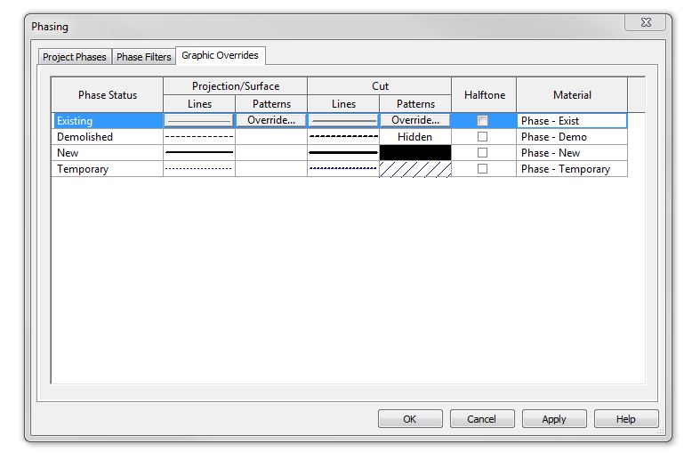

IS THERE A WAY TO MAKE EXISITNG MEMBERS IN A MODEL SHADED EVEN LIGHTER THAN SHOWN
WHEN I PRINT IT DOESNT SEEM TO BE THAT LIGHT?
ANY IDEAS?

You don't tell us what you did so how would we be able to help?
Have you looked at screening?

Change your overrides in your phasing.

THAT IS THE QUESTION. MY UNDERSTADING IS YOU CANT "SCREEN" IN REVIT. SELECTING HALF TONE IN THE PHASING DIALOGE BOX MAKES IT TO LIGHT. IS THERE A WAY TO ADJUST THE LIGHTNESS OF THE LINES?

Under the manage tab / additional settings, you can set the screening for halftone:

As teafoe5 stated, change the overrides in your phasing.
