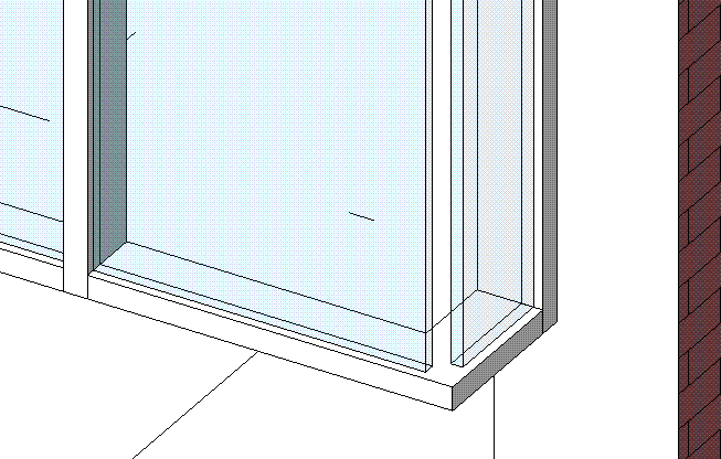

I'm trying to make a curtain glazing system go round a 90deg corner with butt-jointed glass. That is, I don't want a corner mullion, the curtain panels should extend right to the edge - and join properly if possible. See attached for the offending corner. Any clues? I don't want to create a custom family if at all possible, as there are many unique windows in this building that I'd like to be able to easily lay out with curtain grids.

You have to create a new curtain wall family (see attached). After you load it into your project go to your curtain wall properties Edit/New and change your curtain wall to one of the 4 types in the imported family. If you want to use a combination of types just create several similar curtain walls. Hope that helps.

Quoting arccodex1 from 2006-02-24 12:35:45
 "You have to create a new curtain wall family (see attached). After you load it into your project go to your curtain wall properties Edit/New and change your curtain wall to one of the 4 types in the imported family. If you want to use a combination of types just create several similar curtain walls. Hope that helps."
hmm, wheneve i try to load this .rfa REVIT 2010 drops it automatically into the "windows" folder, rather than (i suspect) the profiles/curtain wall folder.
is this correct?
