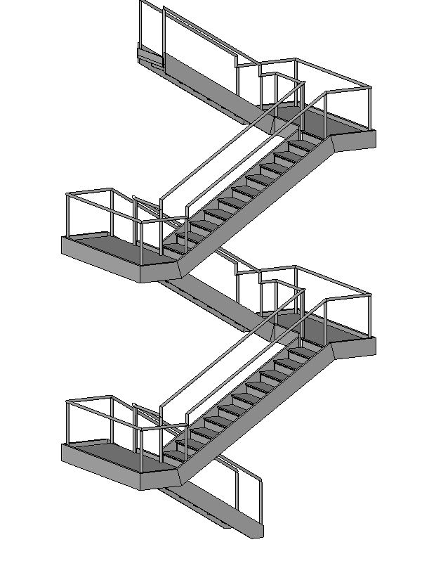

I have a nasty set of stairs, between some levels I have 2 run sets and other levels 3 run sets so multi-storey stairs are not possible (I think). The issue I am having is joining the landing from one set of stairs to the stringers on the next set of stairs the same way Revit creates the joins for mid-landings (see pic). I am creating a set of steel stairs where both landings and mid-landings will be constructed by the stair contractor and will be the same steel structure. Please advise if you know a solution to this problem. I am on Revit 2014.
Thanks

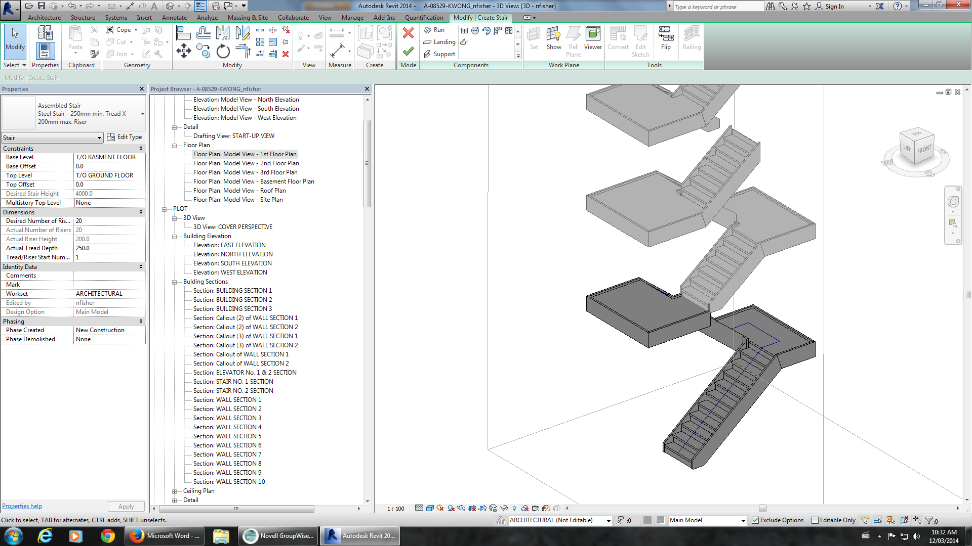

In 2014 you can use stair by component and draw stairs right on top of each other. You can draw whatever lengths you need to get you up to your landings.
I didn't realize you had different RISER heights on each run, if that is the case you will need to do this as all seperate stairs. You may want to even do this without stringers and add them in with beams (C channels) after.

Progress! but can you adjust riser heights between levels when you overlap stair runs as you have? The issue I'm having now is that my landings are not flush with my levels with exit doors because I have levels that do not yield equal riser heights over an continous overlapped stair.

@WWhubb: My suggestion was to do as Teafoe5 showed.
If each run has different riser height you indeed have to draw them as seperate stairs.
Worst case scenario is you model the staircase as model-in-place. Though it is definatly not recommended.
