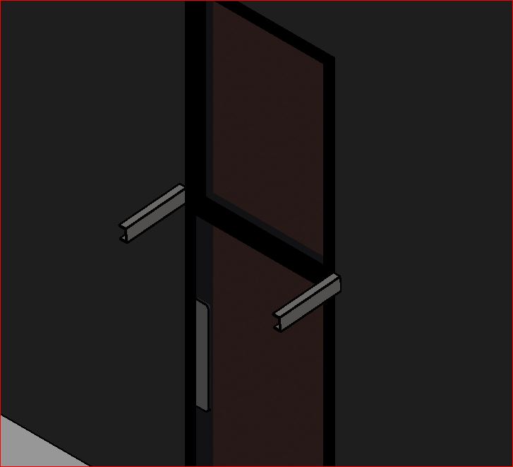

Can anyone lt me know how to mirror a slanted column please? I am using the PFC channel but if I mirror it it stays in the same orientation and doesnt mirror, I need them to face each other. I have tried rotating it, but get the error msg that bottom offset is higher than top offset.

Its ok I worked it out, I needed to rotate it 180 degs in cross- section rotation in the columns properties box
