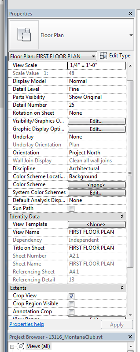

WWHub - I need your help with a similar situation.
Revit 2014
First Floor Plan back references the Exterior Elevation Sheet.
Created the plan "from scratch" using View tab and Plan Views pull down.
Definitely created the floor plan first, before any other views or sheets.
Is there any way I can change the Referencing Sheet (it is grayed out in the properties box)?  Am I missing an update for 2014?  Am I insane? (don't answer that one)
You have always given the perfect and easy to understand answers.  Please help me with this if you can.
Thanks!!

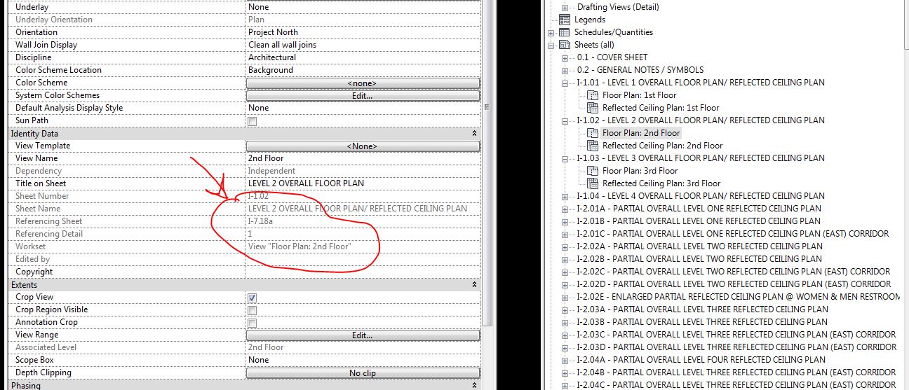

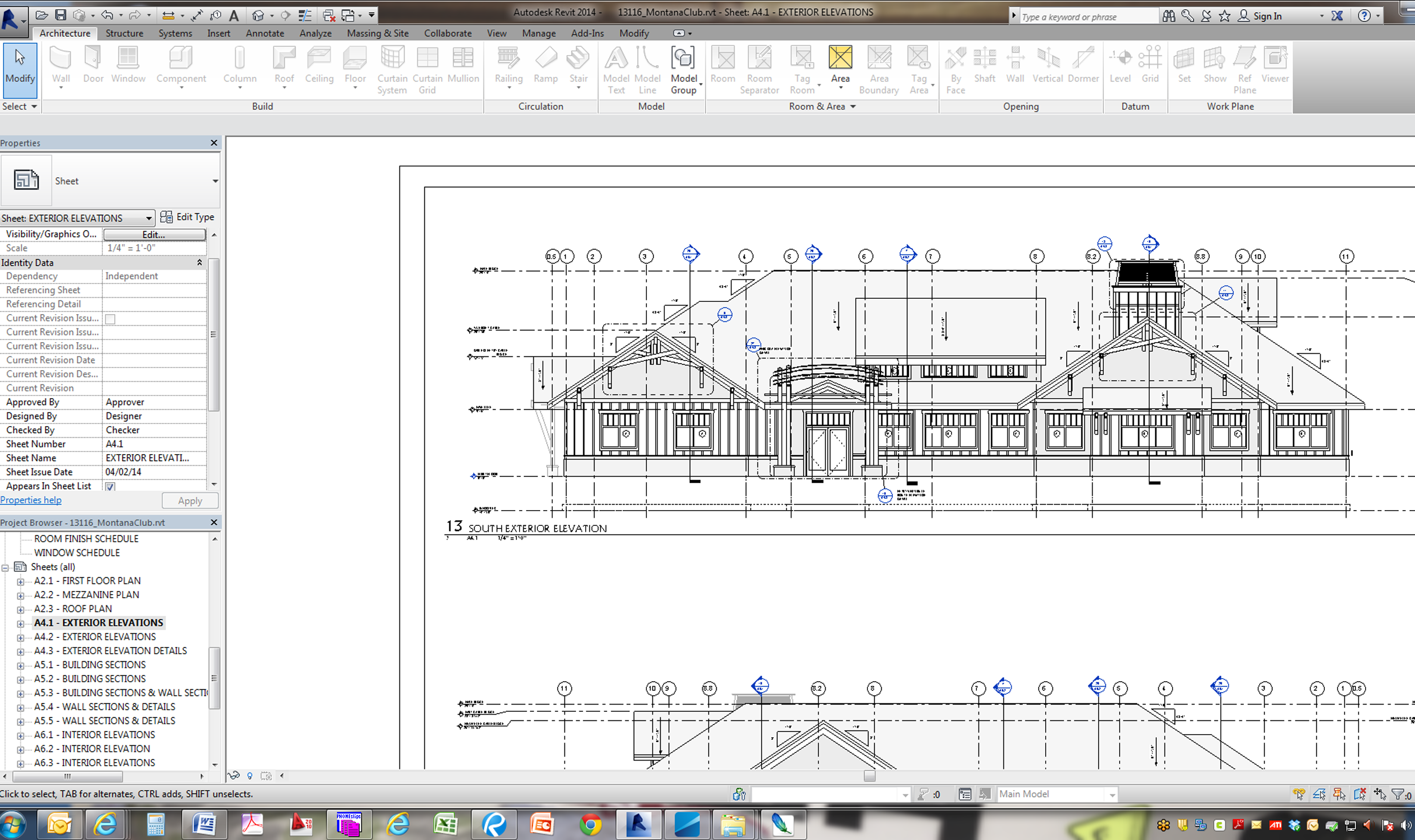

In the lower right corner of the sheet title is what we call a "back reference".  The first sheet number is the main/native/host view the drawing you are looking at came from.  The second sheet number is the one you are currently viewing.  So, in our office sheet naming convention, A4.1 is the first sheet of exterior elevations.  A2.1 is the first floor plan (main view, from which blow up plans or match line plans are hosted from).  When I set up a sheet like A2.1, the back reference is usually shown as a question mark  ? : A2.1.  We would love to have Revit be able to back reference itself since traditionally the back reference in our office for this drawing would be A2.1 : A2.1 I have been able to get the partners to grudgingly agree to accept the question mark.  They will no accept an incorrect back reference.
Hopefully the two files I'm attaching will not waste your time any more than I have already.  The first is a screen shot of the Properties box when I have the floor plan sheet open and the view activated.  You can see the reference sheet is listed as A4.1 and the referring view as 13.  The second file is a screen shot of a portion of A4.1 showing view 13 (and the question mark back reference) and the properties box that does not appear to have any clues linking this view back to A2.1 that I can see.
I am an old architect raised on hand drafting, so when I want plan details, I key them from the plan.  Nice idea to get them from the exterior elevation, though.  Never occurred to me, so fairly certain I didn't do it with this model.  Since I am also one of only two people in the firm who have embraced Revit, I'm certain only I have touched this model.
Please help me if you can.  I truly appreciate all your wisdom and knowledge you've volunteered over the years.  Thanks.  mb

Please don't hit refresh because that causes double posting.  I assumed your last post was a change from the one posted 8 minutes earlier.
The sheet cut from (you call it back reference) sheet shown on process works correctly the last time I checked.  That being said, anytime you see a sheet cut from reference is a ?, then that view is NOT on a sheet.  It is as simple as that.  You cut the reference on a unsheeted view and placed the view on a sheet.  You can see what the host view was by looking at the view properties - it shows where the view was called out.
If a floor plan was created from the VIEW tab / Floor plan drop down (uncheck the do not duplicate existing views) then the floor plan will have no referenncing views - thus you may get the question mark.  You can handle this by having a view type that does not have the cut from parameter.
BTW - I probably have you beat.  Started hand drafting work in '68.
Tue, Jul 8, 2014 at 3:06:01 PM | Showing wrong reference sheet on view title
#12
W O W  !!!!
I just did some more testing and you pointed out a bug.  We don't use the sheet cut from process so I never saw this until I tested it.  Your first two levels were created by autodesk and they have NO refereced from sheet.  So when you create a new level you do so from an elevation or section.  GUESS WHAT!  If that view is placed on a sheet then that view becomes the rference for all future new levels.
This is a bug that needs to be pointed out to autodesk.  For now, you can use my workaround or create your levels from a view that never gets sheeted.
