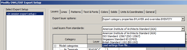

I would like to export to dwg using my own layer standards. I see that you can load settings from file. it looks for a .txt file. how do I create a layer standard into a .txt file? is it something I need to do in CAD?

how do I create an "export layer file (*.txt)" based on my office standards layering system
Thu, Mar 6, 2014 at 10:21:02 AM | exporting to dwg - load layers from standards
In 2014 (you don't say and I will not now look elsewhere)  the file is in C:\ProgramData\Autodesk\RVT 2014.  Copy that to another location, rename and edit as required then use the browse to find it.

Thu, Mar 6, 2014 at 11:16:45 AM | exporting to dwg - load layers from standards
exportlayers-dwg-AIA.txt
Do a search for that file from exployer NOT REVIT! .... You will see different ones in different places.  The location I gave is 2014.

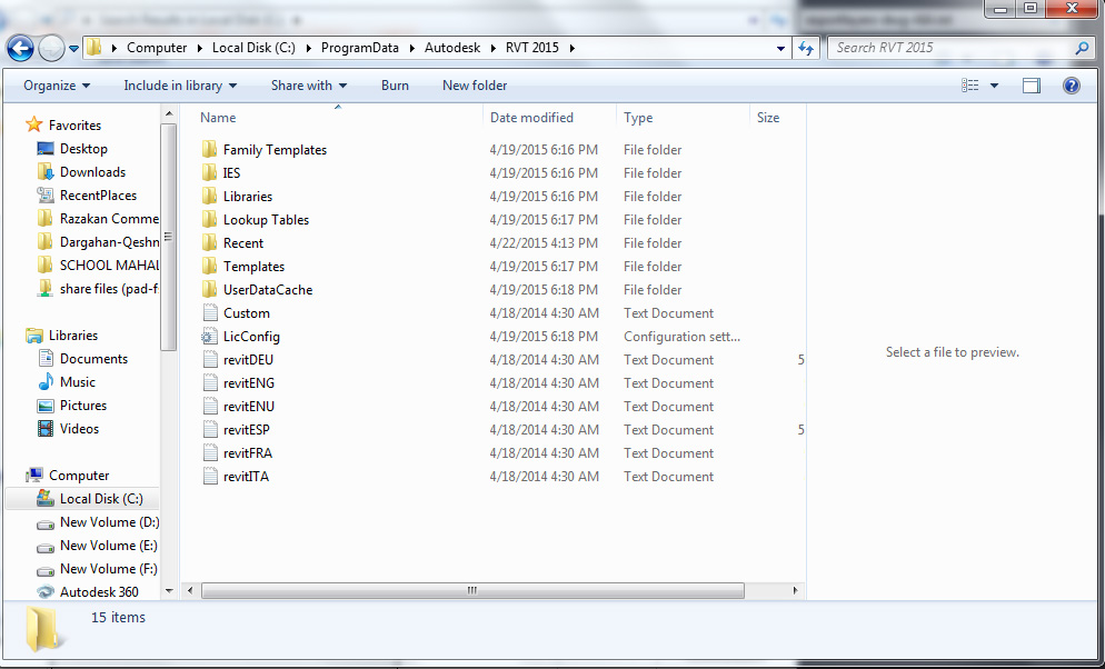

Tue, May 5, 2015 at 6:48:36 AM | exporting to dwg - load layers from standards
keroosheh
Joined: Tue, Jun 3, 2014
0 Posts
ia can,t find this file, too
Tue, May 5, 2015 at 7:58:49 AM | exporting to dwg - load layers from standards
#9
If you had read the other posts in this thread, you should have realized that the location is dependent on the Revit version you are using.  Please be respectful and include your Revit version in your question.
