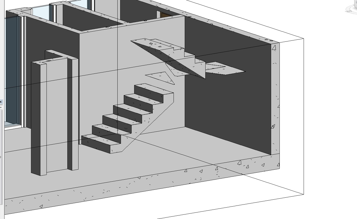

Hi,
please find attached the image of the stairs which havent displayed properly. Im not sure if its some revit bug or the problem of the stair properties.
The landing and some of the treads are missing the thickness and i really dont know what is causing the issue.
Many thanks for help
Luba

This looks like it could be a graphics card problem.
Mon, Mar 3, 2014 at 9:19:29 AM | CAST IN PLACE STAIR PROBLEM
What Revit?  What updates are installed?
This was a problem with monolithic stairs awhile back but I think the updates fixed it.

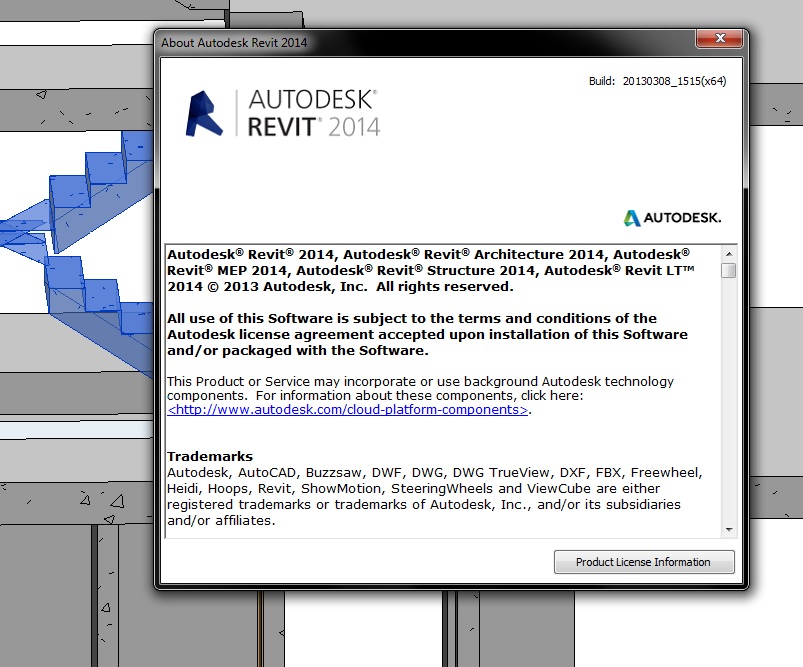

Hi,
im working in Rvit 2014 and how can i find out which updates are installed? Smile
Luba
Mon, Mar 3, 2014 at 9:25:17 AM | CAST IN PLACE STAIR PROBLEM
Under the ? dropdown.... About.

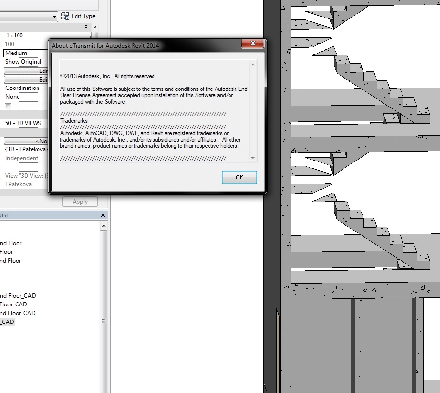

So i find the about dropdown menu but not sure if its the right one..Its in attachment.
Mon, Mar 3, 2014 at 9:42:55 AM | CAST IN PLACE STAIR PROBLEM
It is the dropdown at the question mark:

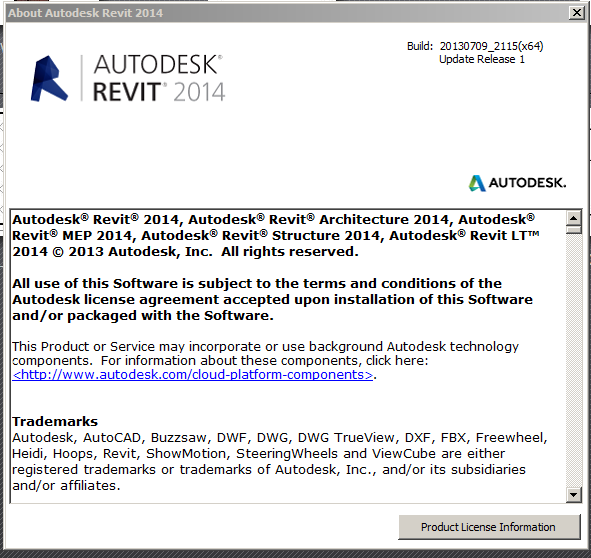

If 2014 - make sure you have Revision 1 installed.
Mon, Mar 3, 2014 at 9:44:47 AM | CAST IN PLACE STAIR PROBLEM
teafoe5
teafoe5 Avatar
Joined: Fri, Nov 12, 2010
1749 Posts
4 Stars: 47 Votes
Just to add to WWHub there are 2 releases that are available with 2014, make sure you install 1 and then 2.
