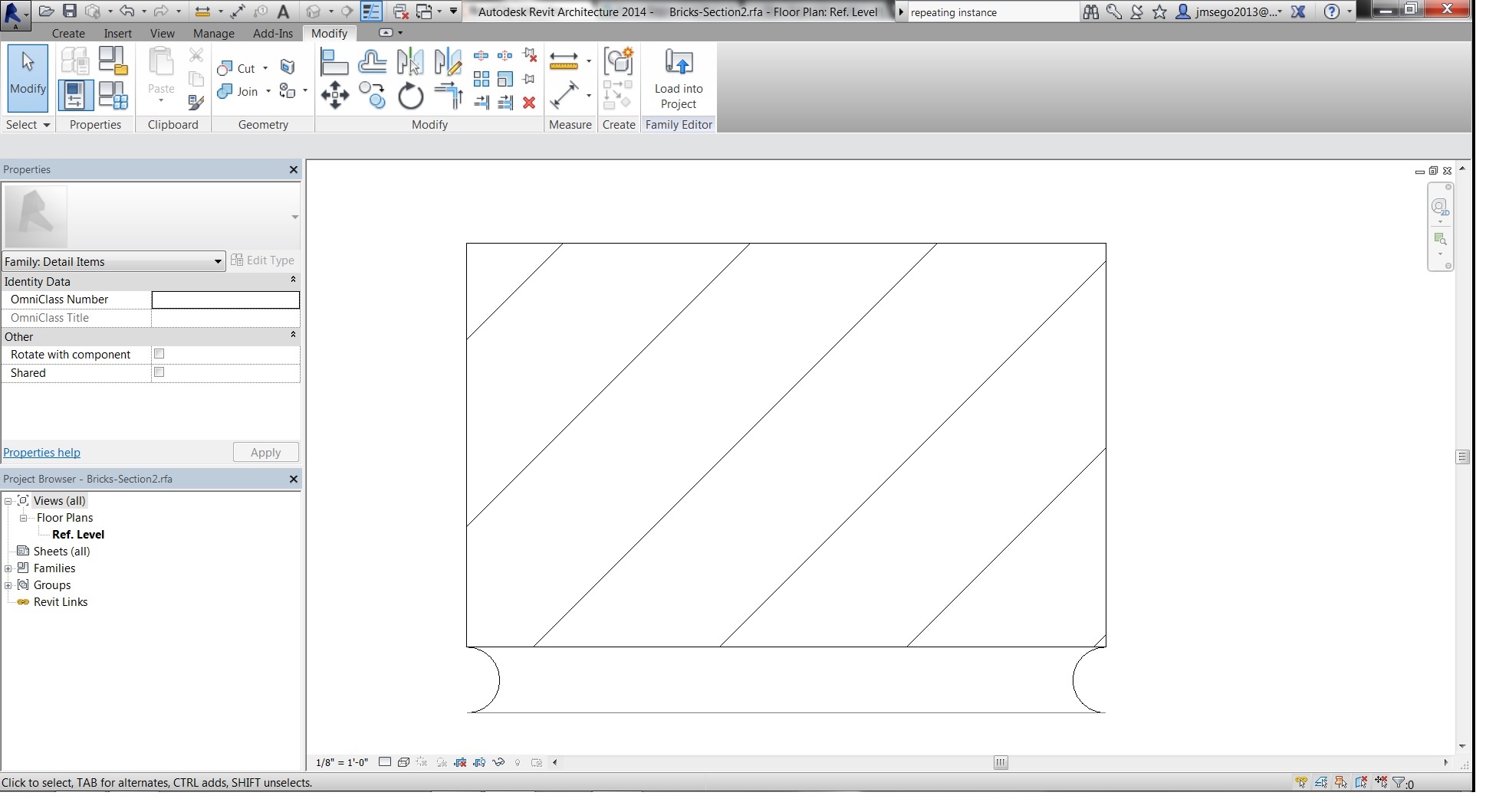

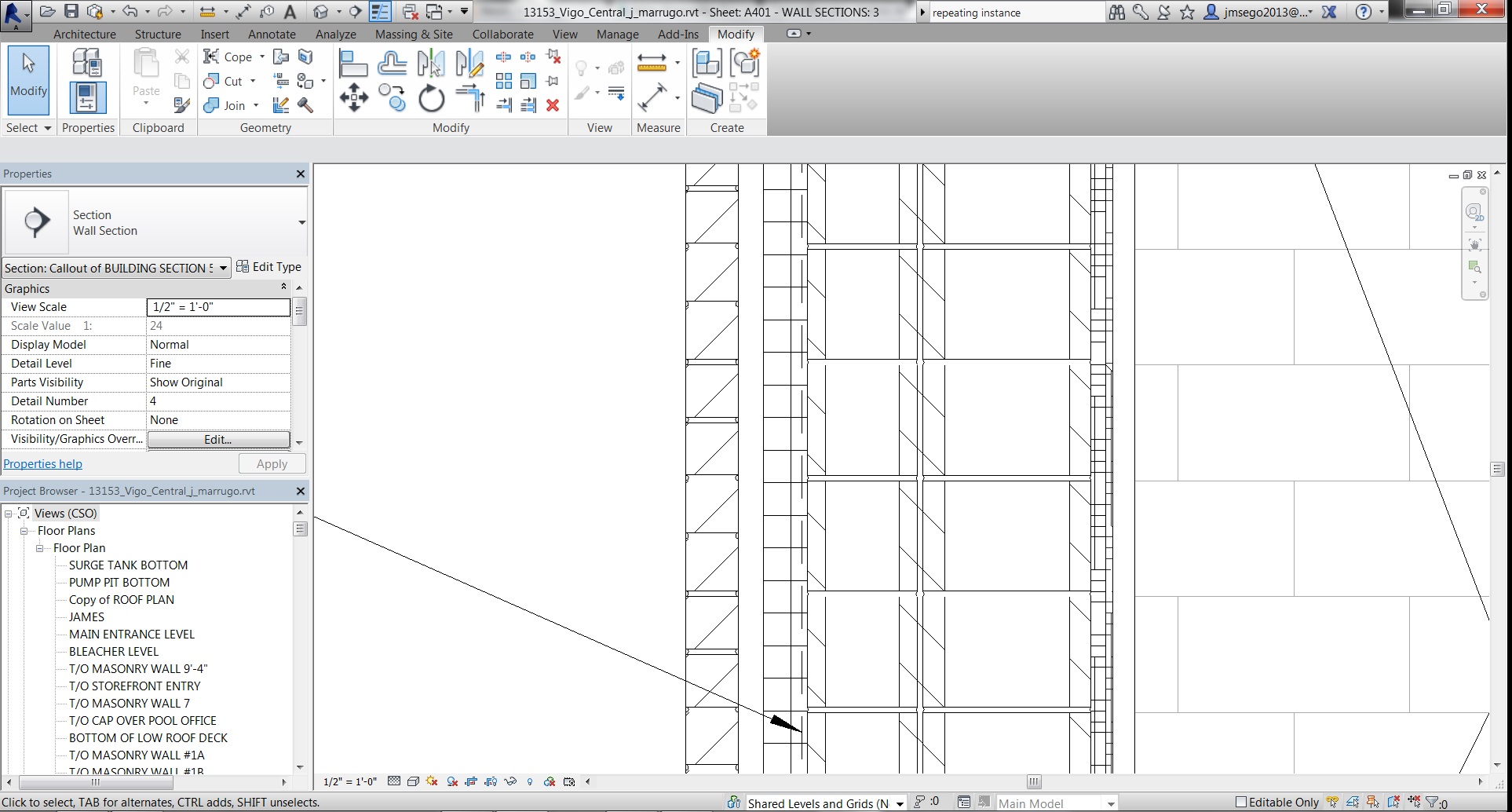

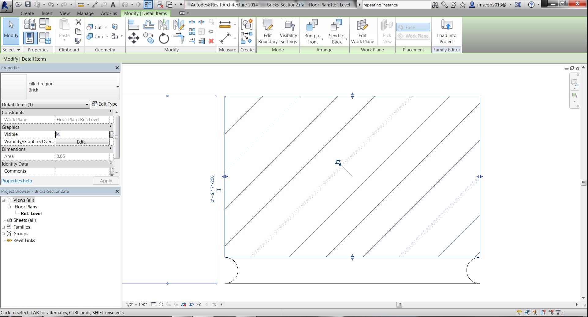

Here are screen shots of my family and how it looks in the sections....at the same scale.

Wed, Feb 26, 2014 at 3:27:55 PM | Issues with Drafting Hatch
As I said.... THE PROJECT RULES.... once a pattern (or material) is defined or loaded into a project by way of a family, the the project dictates how it is displayed.  You can change it all you want in the family and it will not change a thing in the project.
