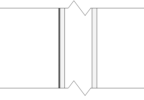

I have included the wall I want to explode that is a model w 3 layers of plaster

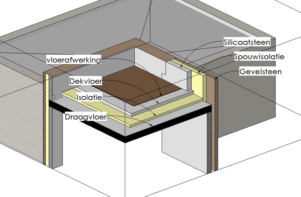

Mon, Feb 24, 2014 at 6:19:58 PM | How to explode anonmeetric walls for detail drawings
CinnamonBird
Joined: Sun, Oct 7, 2012
0 Posts
1 Stars: 2 Votes
the video didn't help.  I have attached an image of what I mean by axonmetric explosion.  I need to draw this in recit.
How would I go about it?

My final attempt at explaining this to you.
Watch the youtube video below, it explains how to divide your wall into parts and adjust the layers.
http://www.youtube.com/watch?v=R3JeYe9s7Po
If you still don't get, I suggest you just model it in SketchUp. Although it's really not that hard in Revit.
