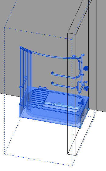

Use a thin tile wall in your model and let your valve host on that.
You can create groups of face based/wall based elements that can be placed in a project and if the project walls are there, the grouped elements will find them.  Here is one of our groups shown in blue.  We keep these groups in a resource project where they can be loaded from.

I'm not sure of what you are really trying to do but here is what we did.
All of our toilet fixtures and accessory items are individual 3D families.  In some of those families, the 3D elements are turned off in certain views and replaced with 2D elements.  (For instance we use masking regions and linework for toilet fixtures which are faceted in elevation views.)   So we load these families into a "resource project" that is kept (along with others) in our library.   In that project, we have walls / floors / work planes ... as required to place these elements in a typical configuration.  We group the families but not their hosts.  Now that group can be loaded into any project and placed in a similar situation where the elements will host to the project elements.
We do thin tile walls in groups as well but for this toilet group, you could include thin tile walls and thus place those along with the other elements.   Once placed in a project, the group can be edited or ungrouped so you could say change the tile or material properties - etc.
