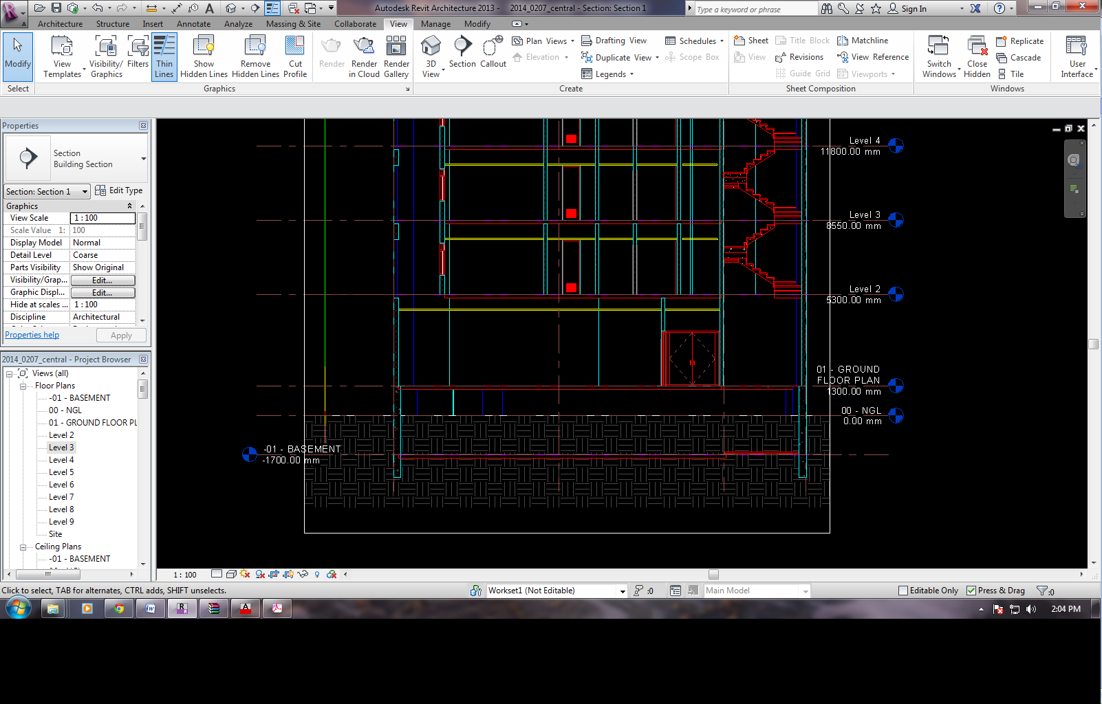

Hi guys,
I need help, please.  I drew a simple flat toposurface on my NGL.  But when I view my building section, the toposurface earth hatch almost filled up my Basement.  What can I do about this?
Thank you.
Pls. see attachment.

You need to add a "building pad"
http://www.youtube.com/watch?v=GRub7cUTURQ

Thanks much KimTaurus.  I did it.  That was very helpful.
