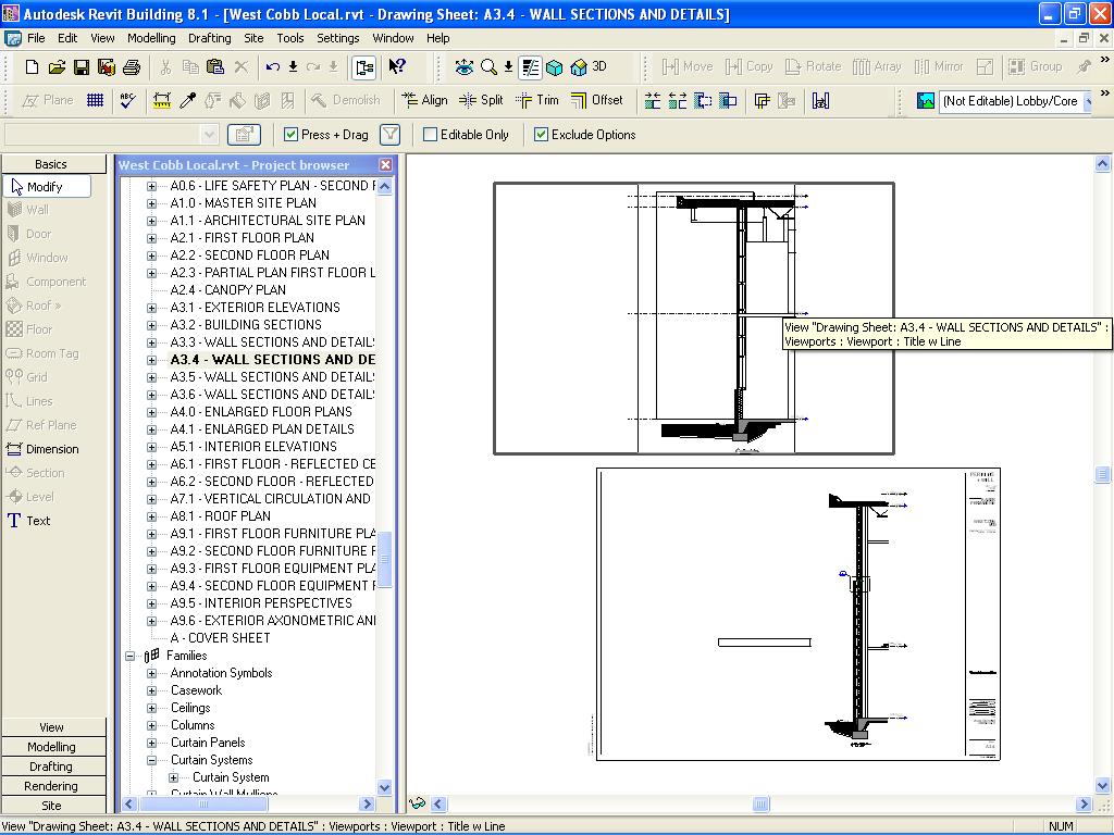

Hi, the selection area is way too large for a view that I have placed on a sheet. It's a big problem because it causes printing discrepancies. This is not a crop region issue, because if you look at the image, you'll notice that the crop region is much smaller than the selection area. In the past, autodesk has solved this problem through a software patch, but I'm wondering if there is something else I can do in case the patch isn't available or doesn't work. Is there something in the properties I can toggle, etc? Thank you

Yes its sometimes caused by curtain wall grids. I haven't seen that issue for a while though. I thought it had been resolved? Are you using the latest build? You can try turning off curtain wall grids... Your selection box isn't really that much larger than the view. Trust me i've experienced much worse. Just means you have to use the tab key to ensure you've selected the correct view.

Thank you, I'll try that. Now how do you turn these off? Curtain wall systems, panels, and Grids (under annotations) hasn't worked. Thanks you
