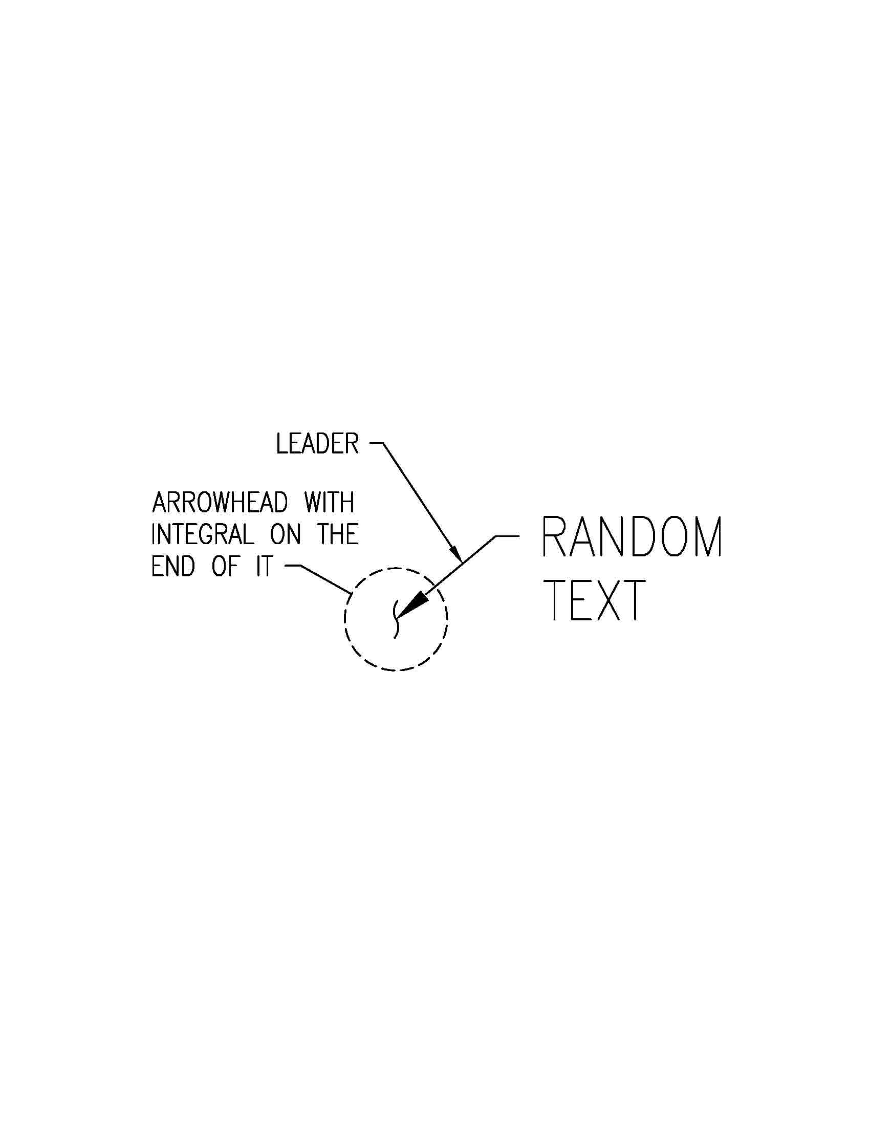

2. Is there a way to create or adjust a leader arrowhead to add a integral perpendicular to the arrowhead? See my picture I've attached.

1. Use Revit 2015, it know hows a built in "Elecation at Top".
2. No not by default.  You could create a detail component with nested generic annotation for the arrow head etc along with parameter for your text/tag.
