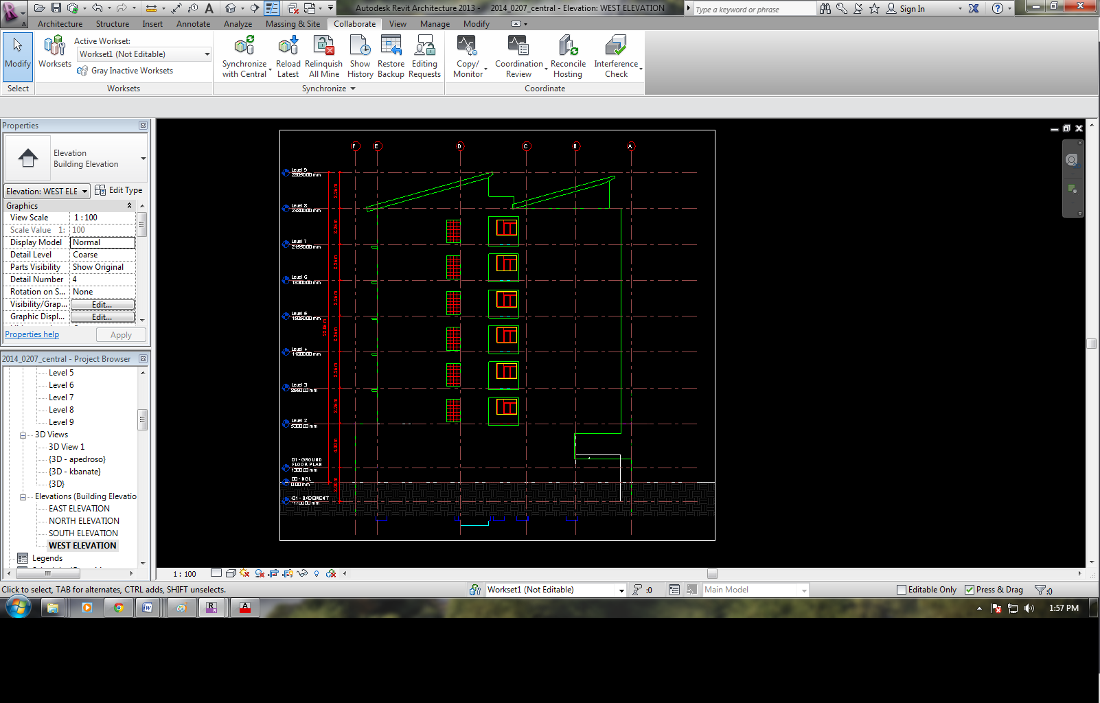

Hi Guys,
please help me on how to deepen the earth pattern of my toposurface, 'coz the other elements, which are (now) deeper than the default depth of earth pattern, are showing up on my elevations.
Thanks.
Wed, Feb 12, 2014 at 4:13:22 AM | Toposurface pattern Depth
gprakash
Joined: Fri, Apr 24, 2009
49 Posts
Hi,
You can do that by changing the vaue of 'Elevation of poche base' on Massing & Site Menu -> Model Site -> Site Settings.
Cheers.
Wed, Feb 12, 2014 at 8:52:55 PM | Toposurface pattern Depth
bigbrother
Joined: Wed, Jan 14, 2009
11 Posts
I did it. Thank you very much for your help.
