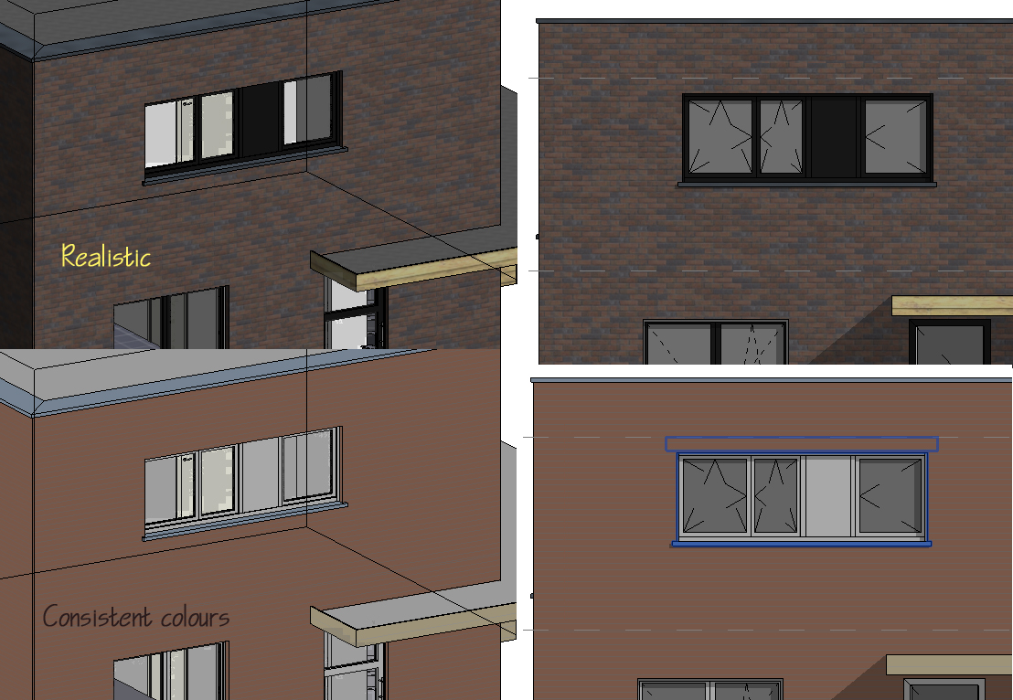

Just trying to show basic colored elevations using consistent colors.
For some reason my windows are all showing up gray? Ive tried changing materials and editing the family with no success.
Has anyone come accross this and can help.
In 3D view when consistent colors is selected it works just shows gray in elevations. I've attached a photo of the issue.

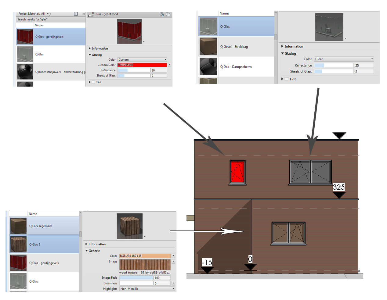

When I change the material of the glazing to let's say brick, it will show as the brick colour in the Elevation in Consistent colours.
Under the materialtab "graphics" Use Render Appearance is checked" for all 3 materials.
Clear glazing doesn't have a colour, so Revit turns it gray.
@WWHUB: what colour do you think it should be?

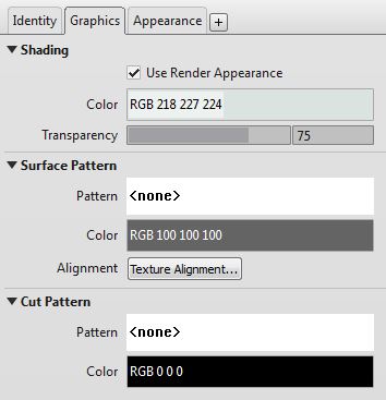

Like I said in my previous post
"Under the materialtab "graphics" Use Render Appearance is checked" for all 3 materials."
If you uncheck this box you can choose what colour the material will have.
For the plain glazing in my example the colour is set to a light grey-green and the transpareny is 75%
Making the glas appear grey is just how Revit deals with clear glazing. If you want your glazing to be a differnt colour, turn of "Use render appearance" and select the colour you want the glazing to be shown in (you might have to change the transparency as well).

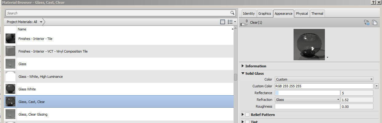

In realistic views, glass will not be transparent. When you set the graphics to use render apperance, the glass is a very light grey/blue/green because it is soda lime glass.
You can't really make glass in a family transparent in realistic view.  You can make curtain wall glass panels transparent through VG.
If you want this glass to be white, then bring in the glass, cast clear material from the AEC and set it to white.

Setting the glas tot white (with a transparency) still gives a grey colour (though lighter) in elevations (Revit-logic).
Anyway, this is not a problem for me, the point here is: we still don't know what @Nowlan's intentions are/were.
Edit: I've noticed that when I turn off the surface pattern for my glazing, it does change the colours. Though this doesn't seem logic since "Realistic" shouldn't take in account the surface patterns.
