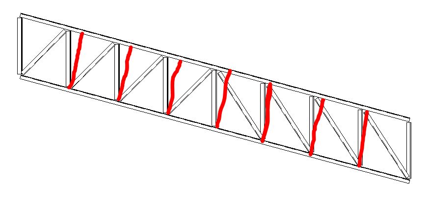

So I hope I'm looking over something somewhere but I can't seem to find the box I need to check or what I need to do.  When you have a truss insterted and each end has different elevation, How exactly do you get the vertical supports and angles braces to rotate with the truss instead of them staying vertical?  I would like my vertical braces to roate also so I have 90 degrees at each "section" of the truss.

Click on your truss and Edit Type and you will get options in there.

Found it.  Thank You!   I was searching around in there so I was at the right area.  i just couldn't find the right option. It was as simple as setting the web option to Ortho.  Much appreciated.
