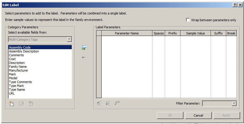

Hi everyone,
Currently working on a furniture layout in a drawing, all the peices of furniture have codes and descriptions.
I have created my families so that the family name is the code and then the description is in the properties.
Is there any way I can get the family name to be displayed next to the peice of furniture as a text box/tag?
I have looked in visibility settings and all the tags are set to viewable?
Is it a tag I need to set?
Thanks
Thu, Feb 6, 2014 at 7:29:24 AM | Family/furniture tags
You can build your own tag - look at the options you have built in - and you can add additional type parameters.
