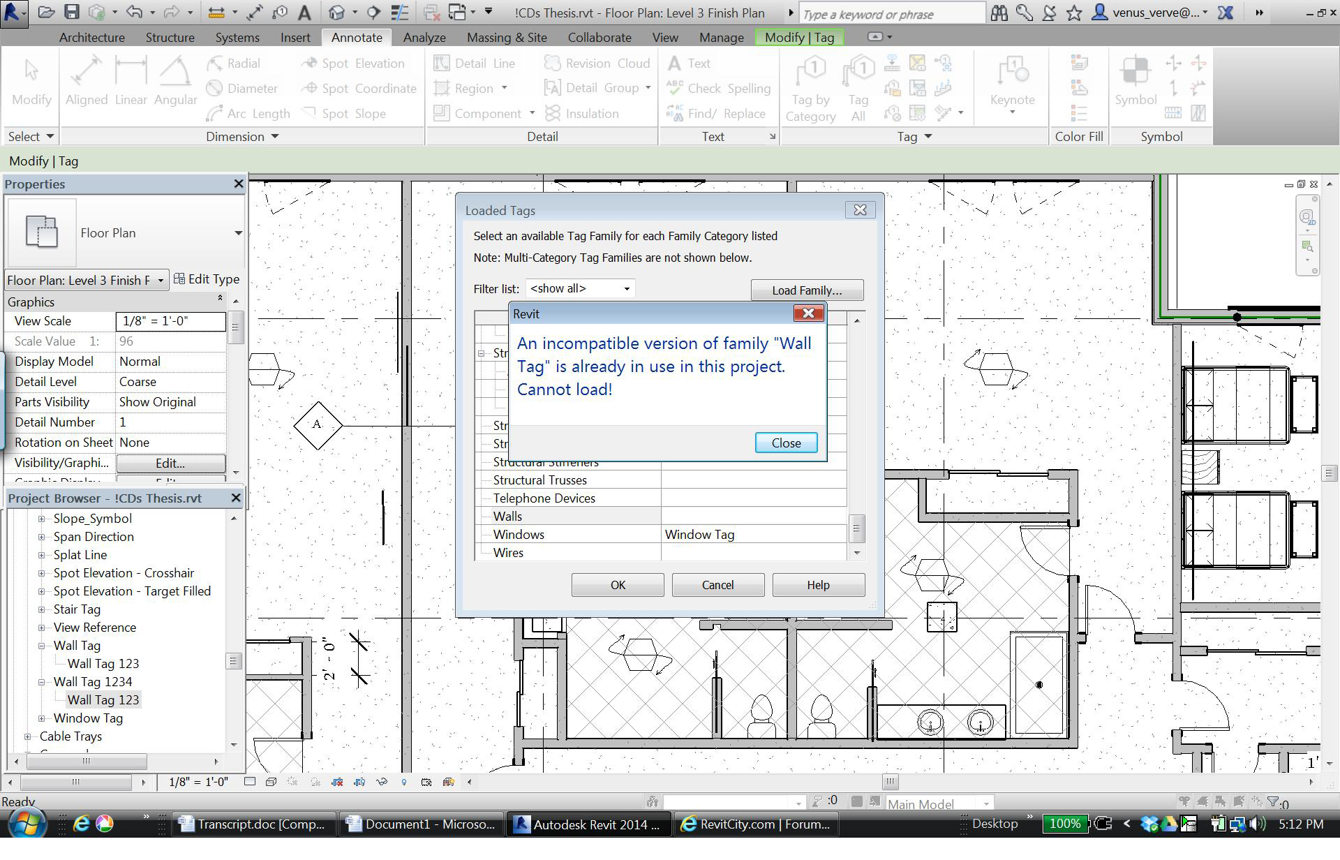

Hello I created a wall tag and didn't know that there were wall tags in architectual annotations.  So the tag I created is in the generic family.  I cannot purge this tage
Nor can I load a wall tag > tag by category > load tags>
I get the error that wall tag has already been loaded and I cannot load the standard revit wall tag.
Hence I have been unable to place wall tags easily.  The generic wall tag I created is not laoding the diamond and when I fo to edit family it says it is a floor tag....
So confusing!  I haven't been able to purge these bad tags  Please help

Don't purge it, just find the family you want gone in your project browser and delete it
Thu, Feb 6, 2014 at 7:26:10 AM | Wall Tags
I see two wall tag families loaded already - not just one so I don't understand what you are doing.  Delete both wall tags and all instances from your project pbrowser and load the wall tag.

it worked!
