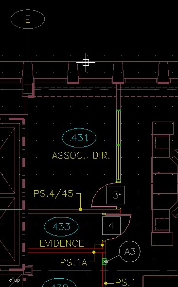

Our office uses a 2'x2' grid system when laying out design work and follows through to construciton documents. The grid is an autocad black
that is visible when printed and we can snap to it. How would I go about creating a family that is based on a 2'x2' grid that is visible
and can eb snapped to?

It's not a grid made of lines rather it's a grid made up of dots.

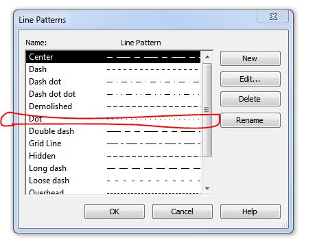

So create a line with a dot pattern.
I didn't look at your photo, I think your best bet is going to be creating a generic model family as WWHub said

You can create a model based family that is your dots.  Use a non cuttable family template and have reference planes in both directions on your 2' spacing.  Set all reference planes to "Is Reference".  Add a vertical element - invisible line - that is taller than your building.  Insert this into your project in a special workset so you can turn it off when you want it off. Pin it.
Now it will show in all plan views.  You can align & dimension to all the reference plane locations.
