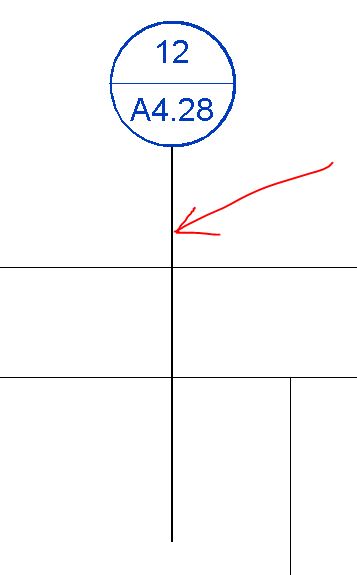

I have been trying to figure out how to make our detail references read more clearly. I have already applied a white fill to the detail bubble which helped immensely, but there has been a request to beef up the line weight of the detail section line. Does anyone know where this setting would be? I can’t seem to locate it in the usual places.
Fri, Jan 31, 2014 at 11:38:44 AM | How do you adjust detail section cut line weight?
Set this in your template and in any projects in Object Styles/Annotations.
Fri, Jan 31, 2014 at 11:43:55 AM | How do you adjust detail section cut line weight?
vsco1128
Joined: Tue, Sep 16, 2008
6 Posts
Not sure how I missed that! It was right there under section line. Thanks!
