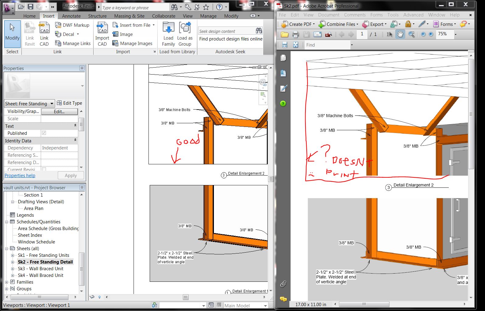

Can someone tell me where the option is to get the borders on the drawings to print in the PDF. the screen shot shows revit on left, PDF output on right.
revit 2011, thanks in advance.
edit: just realized I spelled vertical wrong..lol.

in the print menu go to setup.
here @ the botom you can find the options un check the pickbox Hide crop boundaries
Thu, Jan 30, 2014 at 7:40:35 AM | PDF print, no window border
The crop boundry would also ahve to be on in the view.

also the print scale should be set @ 100%

Thanks!! perfect.
