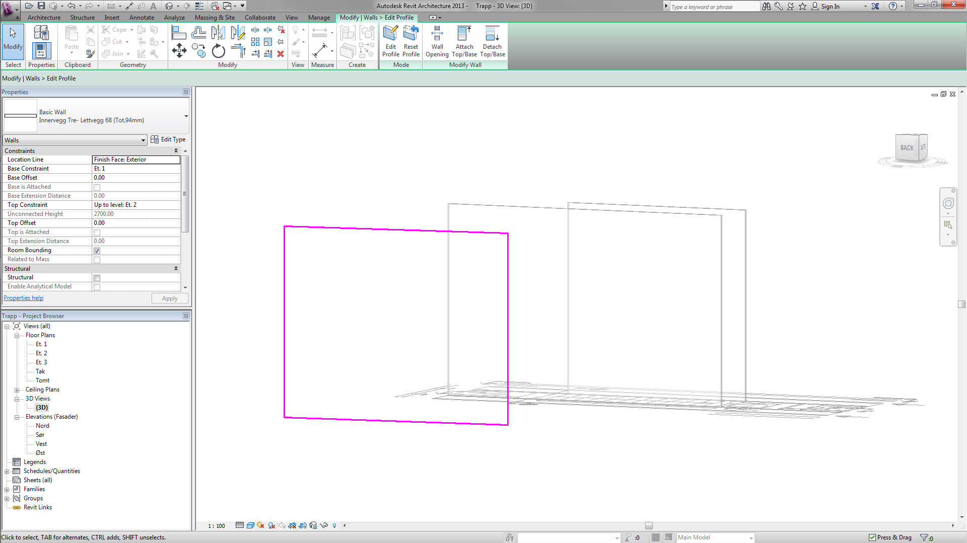

I have a problem when I'm trying to Edit profil in Revit 2013. There are 2 problems and I cant find the solution and dont understand why! One of the problems is that when  I push Edit Profil there are no  cancel button ore no approve button. No line button ether!! Pic 1....

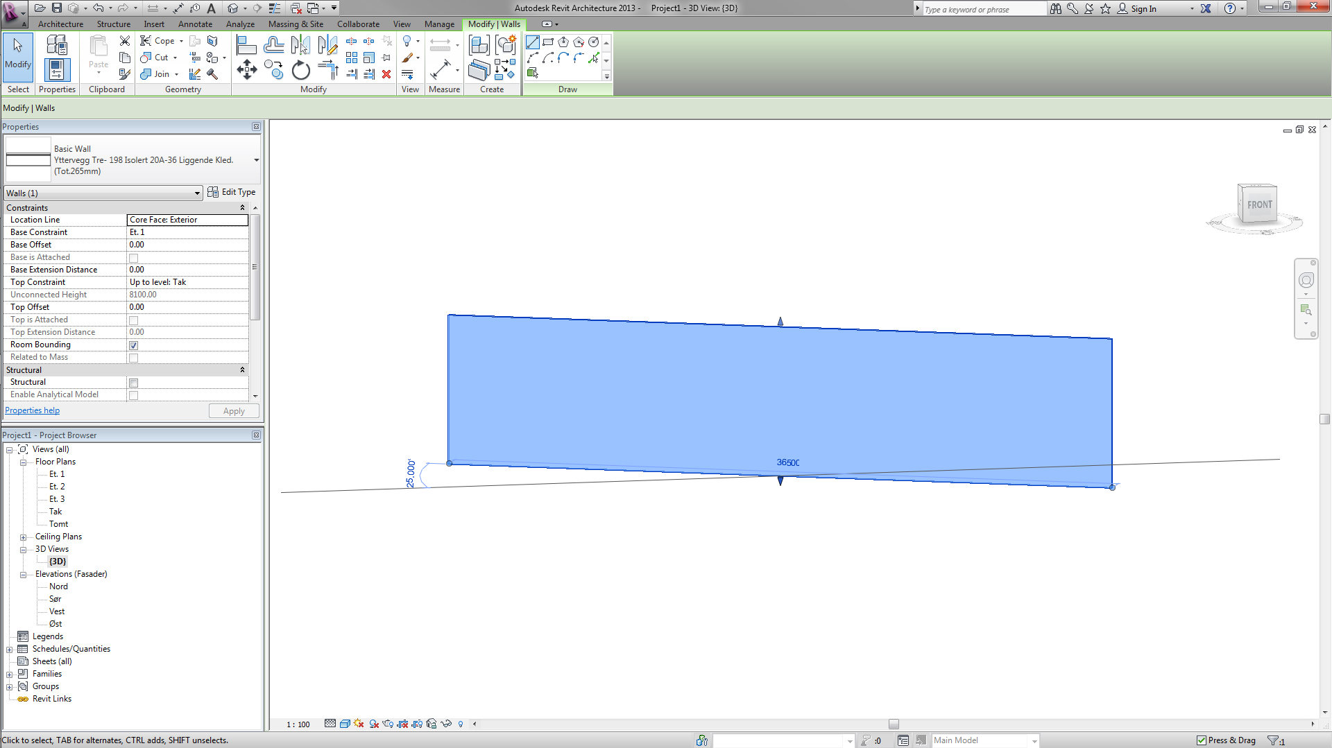

Next problem is that when I push Edit Profil the only thing that appers are Draw line but cant use Draw Line!! Pic 2
These problems just happens in different approches and can happen to the same project when I try to restart Revit ore restart the computer.

This is a very simple answer.  You have failed to keep your program updated.  There are 3 service packs for 2013 and I doubt you have them installed.

Thanks! Been searching/looking after updates but havent found anything yet. Do u know where to find updates?

Been searching?  Where?  Simple google search brings up: http://usa.autodesk.com/adsk/servlet/ps/dl/index?siteID=123112&id=2334435&linkID=9273944

Boom!!! I'm on tha roll again. Thanks M8 B-)
