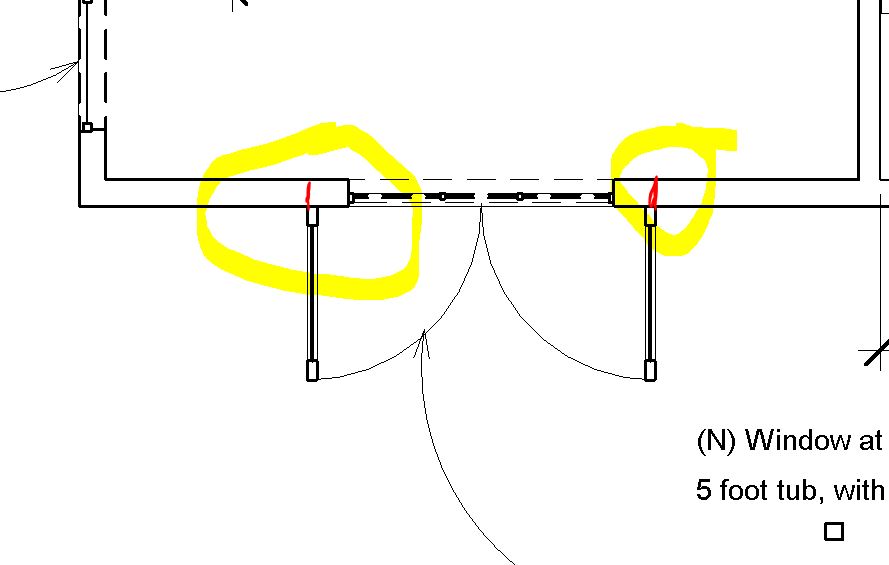

Is there a way to get the door to show where it ends at the new door jamb when cutting a new door in an existing wall?
see picture.
thanks in advance.

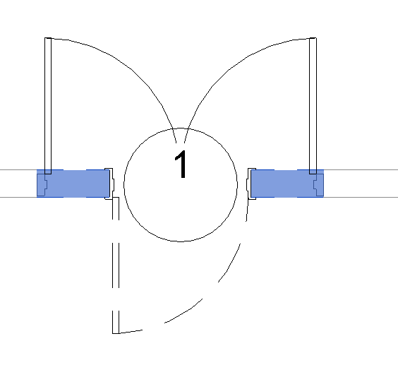

Typically we don't show both new and existing in the same view.  Show all will not work initially.  .... but
  1. Tab select the wall that gets demoed for your new door
  2. Then over-ride graphics in view by element and make that transparent.
