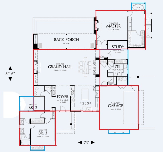

okay....so as you can see, the roof looks sectioned off to get those 3 shed roofs. while trying to section them off and creating the 3 different roofs, the lines of the roofs cannot overlap, butwhen trying to get as close as possible to other roof so that there are no gaps in the roofing, i get this error message:
"This sketch defines more than one footprint.  Make sure the sketch contains only one outermost loop and that there are no loops inside inner loops."
what is it that I need to do to get it so that the roof is sectioned off and without gaps without overlapping lines or this error message?
thanks in advance!

WHICH IS WHAT I TRIED TO DO BUT THERE ARE GAPS BETWEEN, SO I TRIED TO EXTEND THE LINES OF THE ROOF , BUT THEY EITHER OVERLAP OR I GET THAT ERROR MESSAGE.

it would help if you posted a plan with the magenta coloured sketch lines where you want them. pdf is ok
so we can see what you are trying to do.

SO IM @ WORK AT THE MOMENT & FORGOT MY THUMB DRIVE @ HOME SO HAD TO ROUGHLY DO THIS ON PAINT. THIS IS APPROXIMATELY HOW I WOULD THINK THE ROOVES ARE BEING DIVIDED. PLEASE CORRECT ME IF I AM WRONG. THE BLUE OUTLINES ARE FOR THE FLAT ROOVES FOR THE PROTRUSIONS.
I AM SO SORRY IF I MAY BE ASKING SILLY QUESTIONS OR IF IM BEING A LITTLE FRUSTRATING, LIKE I SAID I AM MORE SO A VISUAL LEARNER. I FEEL LIKE IM ON THE BRINK OF UNDERSTANDING THIS, BUT IM MISSING SOMETHING.
AS ALWAYS THANKS FOR ALL YOUR HELP & PATIENCE WITH ME Smile
