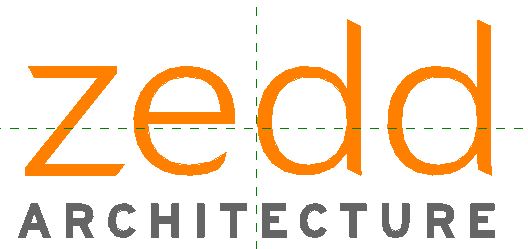

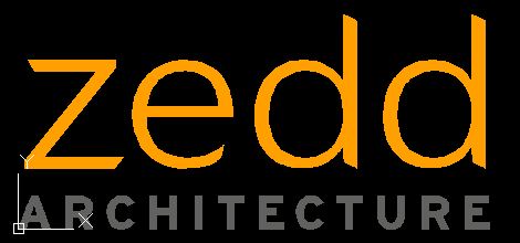

I'm having an issue using 2014 suite of products.
I have our company logo in AutoCAD which has some colored solid hatch. When I import CAD and insert the dwg file into my title block family it is clear that the colors have changed. If I explode the dwg I can then see the layer colors in the object styles dialog and the layer colors have in fact changed. I have selected for the colors to be preserved in the Import Cad dialog box.
Does anyone know why the layer colors are changing?
Thanks,
Jason

Thanks for the responses.
I didn't think you could link a cad file into a title block family. Link Cad is greyed out.
Revit is up to date with patches.
I inserted the cad file using Preserve colors.
I only have a few dozen lines in my cad file. 2 layers.
Layer 1 is color 255-159-0 (RGB). Layer 2 is color 97-98-96.
Once inserted into Revit the colors are: Layer 1 255-127-0, and layer 2 is 101-101-101.
How is this possible?

Would you be able to upload the CAD file to here so I can try to import it and see if I am getting the same problem?
Fri, Jan 17, 2014 at 9:14:41 AM | autocad layers change color when imported into revit
jkipfer1
Joined: Fri, Jun 3, 2011
0 Posts
That would be great, thank you.

I'm not sure why it is not keeping the exact same colors from AutoCAD to Revit but they look VERY similar so I don't see the problem just using that.  Also when I explode it and go under visability graphics>object styles> I can change the color to be the same as the CAD colors.  If I were you I would change the scale to what you need in AutoCAD then bring it into Revit and use filled regions to create your logo.  I have attached a sample.  Your other option would be to try and create a higher quality jpeg.

What Revit does it to approximate the colors to the nearest 255 index color, but whit RGB values.
You must always use the By Layer color and then, in Revit Object Styles chage the color to the correct RGB.
