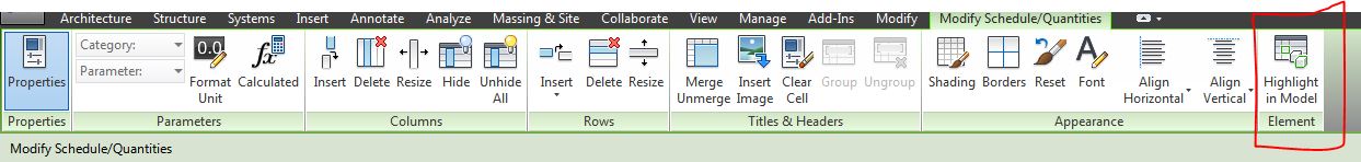

Hey everyone,
I'm having trouble locating devices in the revit file. I have them all scheduled and circuited, but it's a rather large building so when I go to look for the location of the device it takes a while. Is there a to have Revit open a view where the device is located from the schedule or through the Panel Schedule. In Revit 2013 I could open a view using the 'show' function but I can't seem to find it in 2014.

In your schedule click on the device you want to located and then under the Modify Schedule/Quantities tab hit Highlight in Model.
