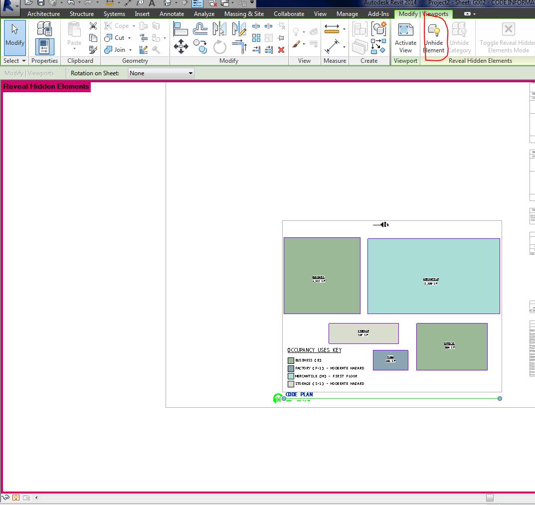

I am using 2013 Revit. the view title is hidden and the unhide element is grayed out. I'v looked at visability graphics and it's on. Any idaes ?
Fri, Jan 10, 2014 at 10:16:35 AM | view title is hidded
How do you know that it's hidden?
I can't hide a view title but I can set the view to No Title.  Click on the view and see if that is what was done.

View Titles cannot be hidden but they can be set to none...Click on your view on the sheet and in the Properties type selector select a Title Type

checked all that, the only way i can see it is to turn on view hidden on the sheet.

I guess I was wrong, if you click on the actual view and hit hide element it will hide just the View Title (sotra weird).  With the hidden elements turned on click on the view and click Unhide Element.. see image
Fri, Jan 10, 2014 at 10:25:53 AM | view title is hidded
I'll be darned.  You can hide a view title but you hide it by clicking on the view - not the title.  You un-hide it the same way.  Show the hidden elements and click on the view - then un-hide elements.

unhide is grayed out?
Fri, Jan 10, 2014 at 10:35:59 AM | view title is hidded
#9
Click on the view - NOT the red title.

that did it thank you so much, I have never seen it do that before could I have inadvertedly turned it off.
