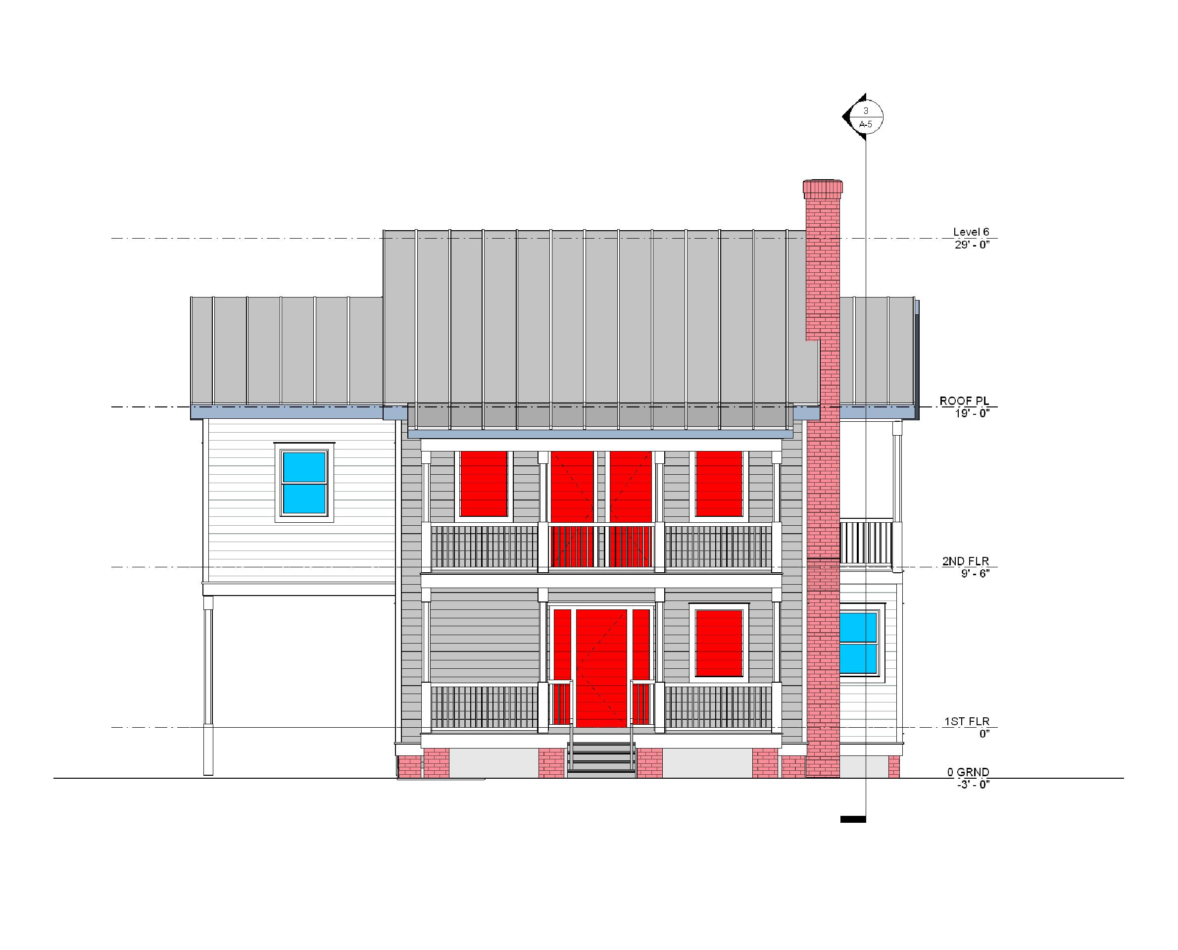

I am working an addition and renovaition to residence. I have several situations I need help: 1- I have an existing Wall in which I am intalling new doors and windows the problem is that Revit automatically places an infill that does not allow me to see the new windows. What do I have to do to be able to show the new doors/windows in the elevations hidding the infill? I tried to delete it and it does not allow me to do it unless I erase the window. 2. Is there a way to hide all new work to be able to show demolition drawings without any new work? 3. when I am executing a walk, I have not be able to hide the removed wall, it shows as blue shade in the middle of the room. I will appreciate a prompt response Post edited on 2006-02-21 00:50:41

1. Make sure your phase filter isn't set to show all, set it to show complete if you don't want to see demolished items and ensure your wall is in the existing phase and your doors/windows are in the new construction phase. 2. Yes create a phase filter to only show existing and demolished with the appropriate overrides if you need them. 3. Sorry you lost me on this one? Can you clarify what you're referring to?
