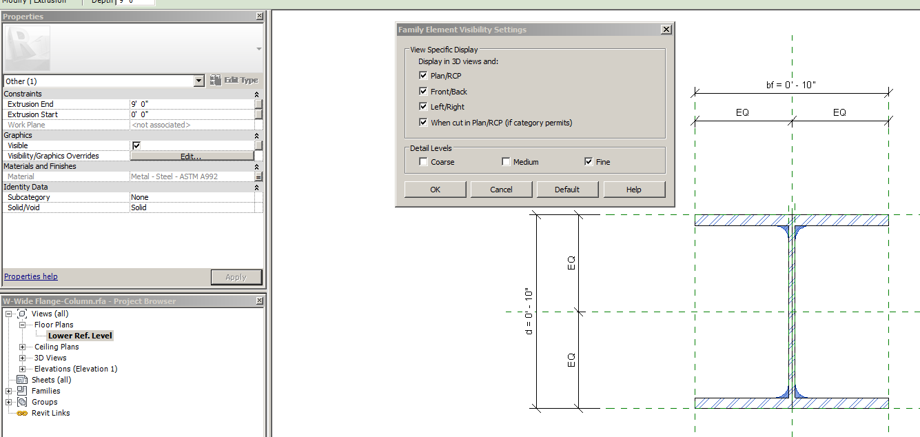

CHECK THE VISIBILITY SETTINGS IN YOUR FAMILY - SEE ATTACHED

ive checked the medium view in the column family and still it doesnt seem to show up in the view. Very confusing ??

Hi Hub, yes, I did follow through with the thread--I would not have posted otherwise.  The original poster did not respond that their issue was resolved so presumably the original poster also went through the thread and was not able to resolve their issue.  My only possible conclusion right now is that it might be the family, but not exactly the issue you might think it is.  I tinkered with the visilibility settings of the geometry (Course/Medium/Fine) in the family itself to no avail.  Interestingly enough, the geometry whose visibility is set to course in the Structural Column family is visible in the project, but that piece of geometry is set to turn off and another is set to turn on (the geometry that more closely resembles the HSS member) when I set it to Medium/Fine, but this isn't happening in the project after I update the family and import.  I can't figure out why.
I ended up setting the view to Medium, but then using VG to turn my Structural Columns to Course, so that my columns reappear.  It's so strange.
