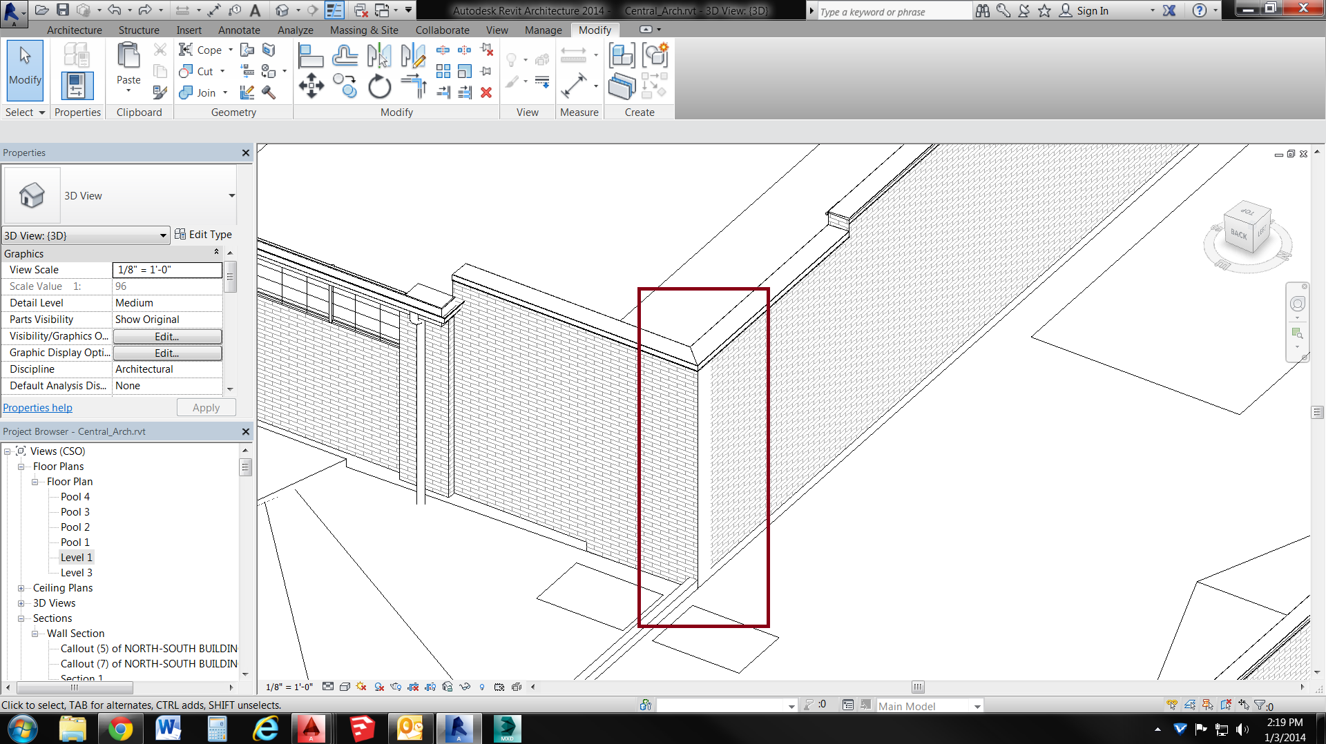

Hello,
I have two walls that have edited profiles.  At the corner of their intersection, the brick material is not wrapping around the corner, even though it's checked in the properties.  Any ideas how to get it to show?  See attached image.
Thank you!

Are the wall corners 'Mitered" ? Have you tried using the 'Paint' tool to fill in the material ?

Thanks for the reply!  Honestly, I didn't know about the paint tool and it did exactly what I needed it to.
