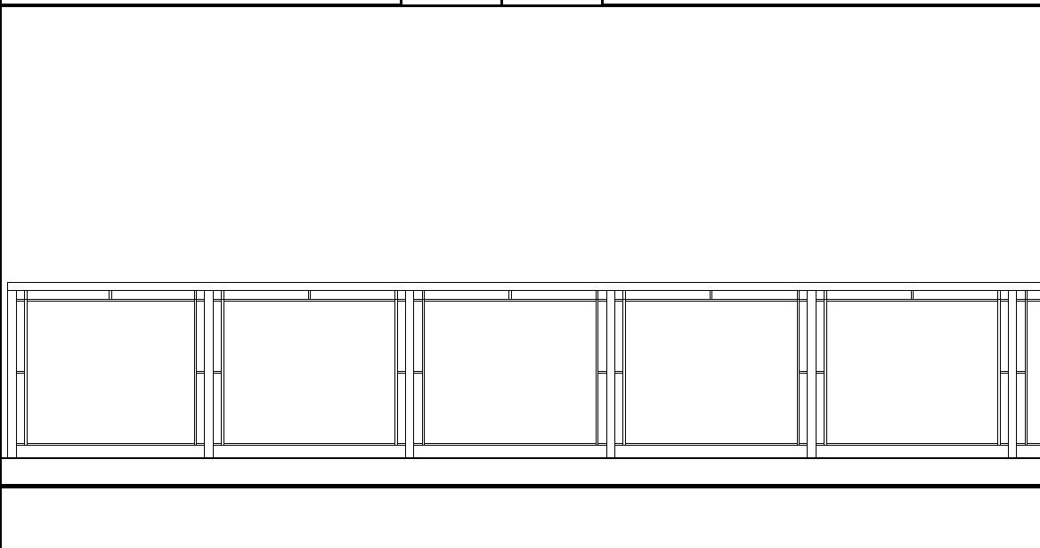

I am creating railings using storefront systems.  I created a panel that works well when used in the typical 90 degree justification.  However, when I rotate the storefront grid system, Revit will not "make" the panel I created.  When I rotate storefront, the shape is still rectangular.  Does anyone have any ideas how I can make my panel cooperate with a rotated storefront?  If no, how can I make one that does?

Thu, Jan 2, 2014 at 2:12:19 PM | Rotating Storefront Panels
amber01aggie
Joined: Wed, May 21, 2008
24 Posts

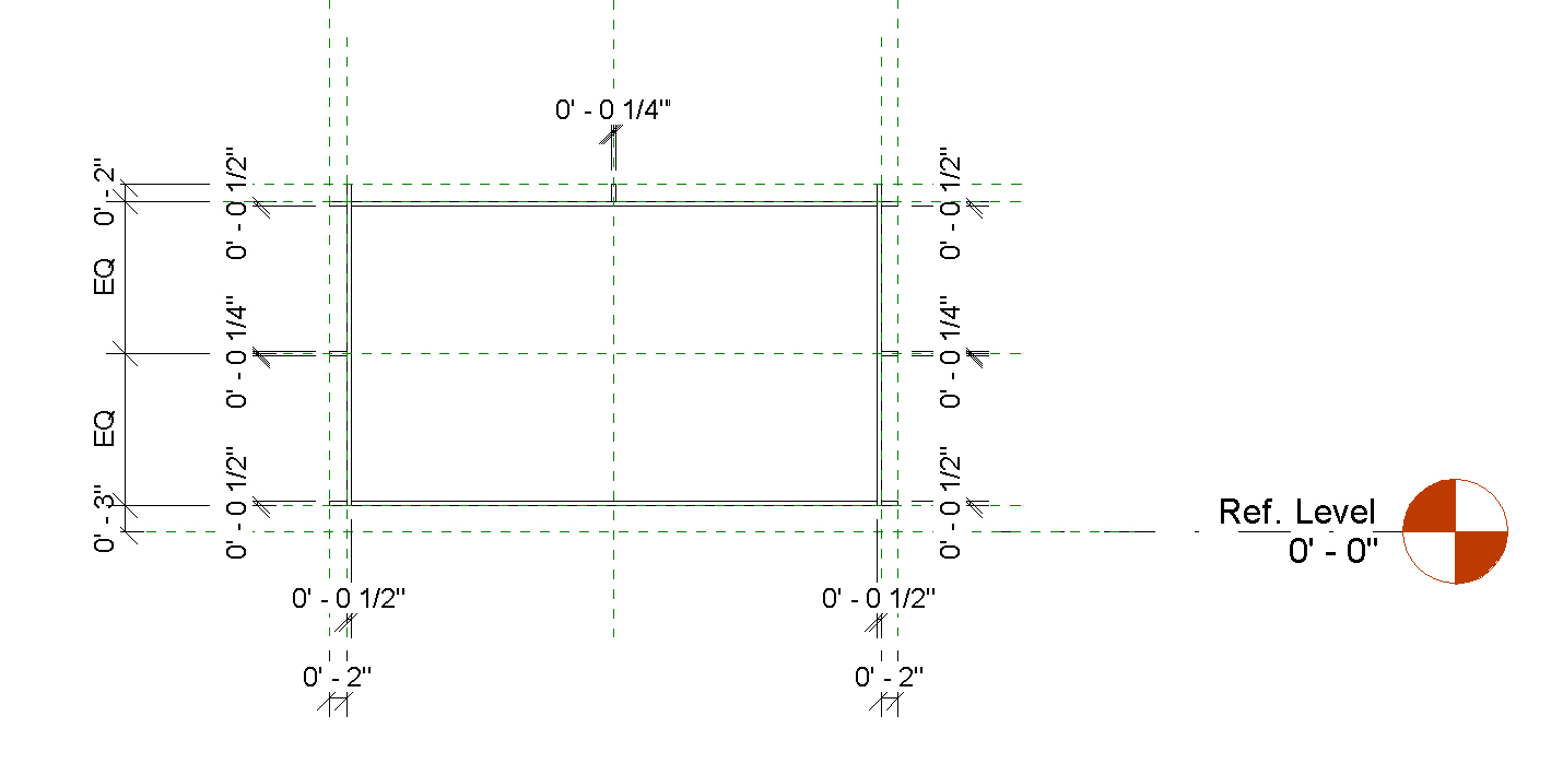

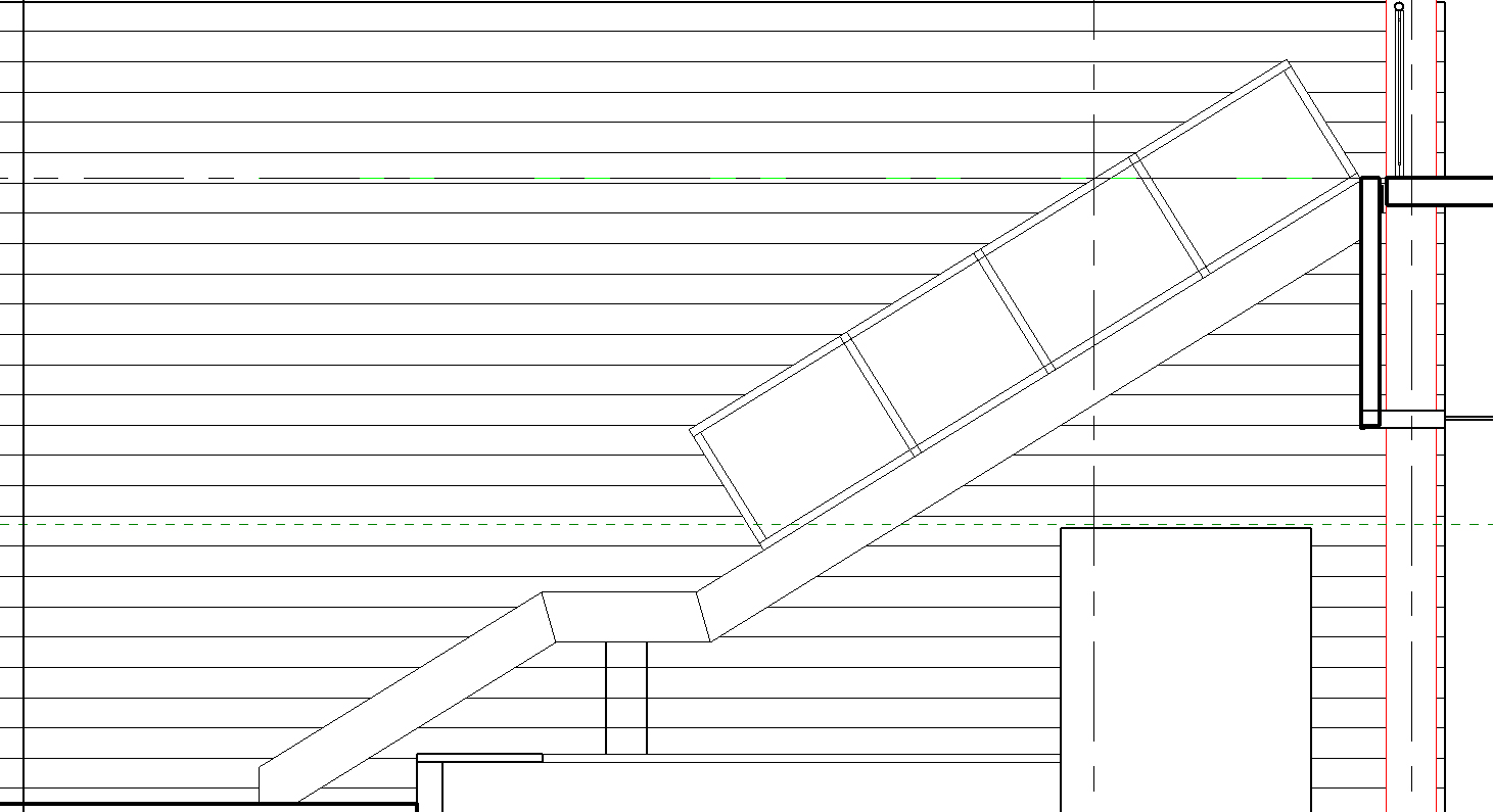

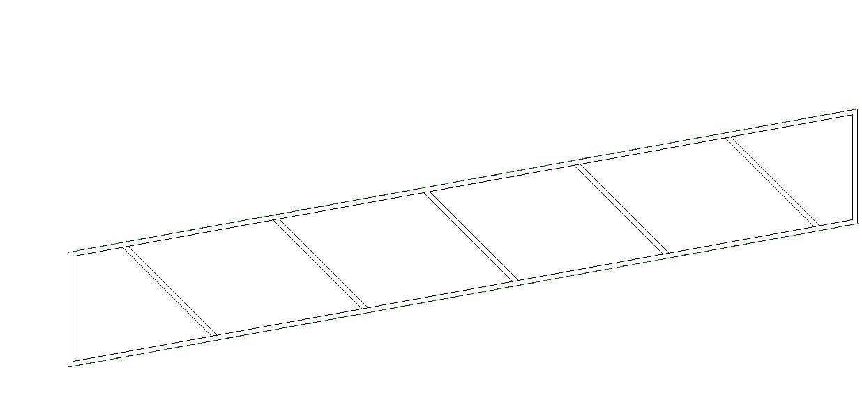

I created my panel by using the "Curtain Wall Panel" template.  The infill will be perferated metal panel, although I haven't modeled it that way yet. The frame and standoffs are what I couldn't get to model correctly when using the railings tool. Using the (terminology correction) Curtain Wall tools, I was able to create an editable, adjustable width railing that is easy to use and holds my frame and stand-offs in position while adjusting panel widths.  However, once I rotate the Curtain Wall these panels apparently cannot be created.  I rotated the Curtain Wall by first configuring grid layout with the angle I wanted (inside mullions turned the correct angle) and then reshaping the profile lines (outside boundary reflects the shape I need for the railing).  The mullions for the curtain wall are round tube steel.

Got it, WWHub!  Now, back to figuring out this railing.  I am creating the handrail using the railing tool.  The guardrail is still an issue.  I cannot get the panels to model.  How do I get them to model with the rest of the curtain wall system?
