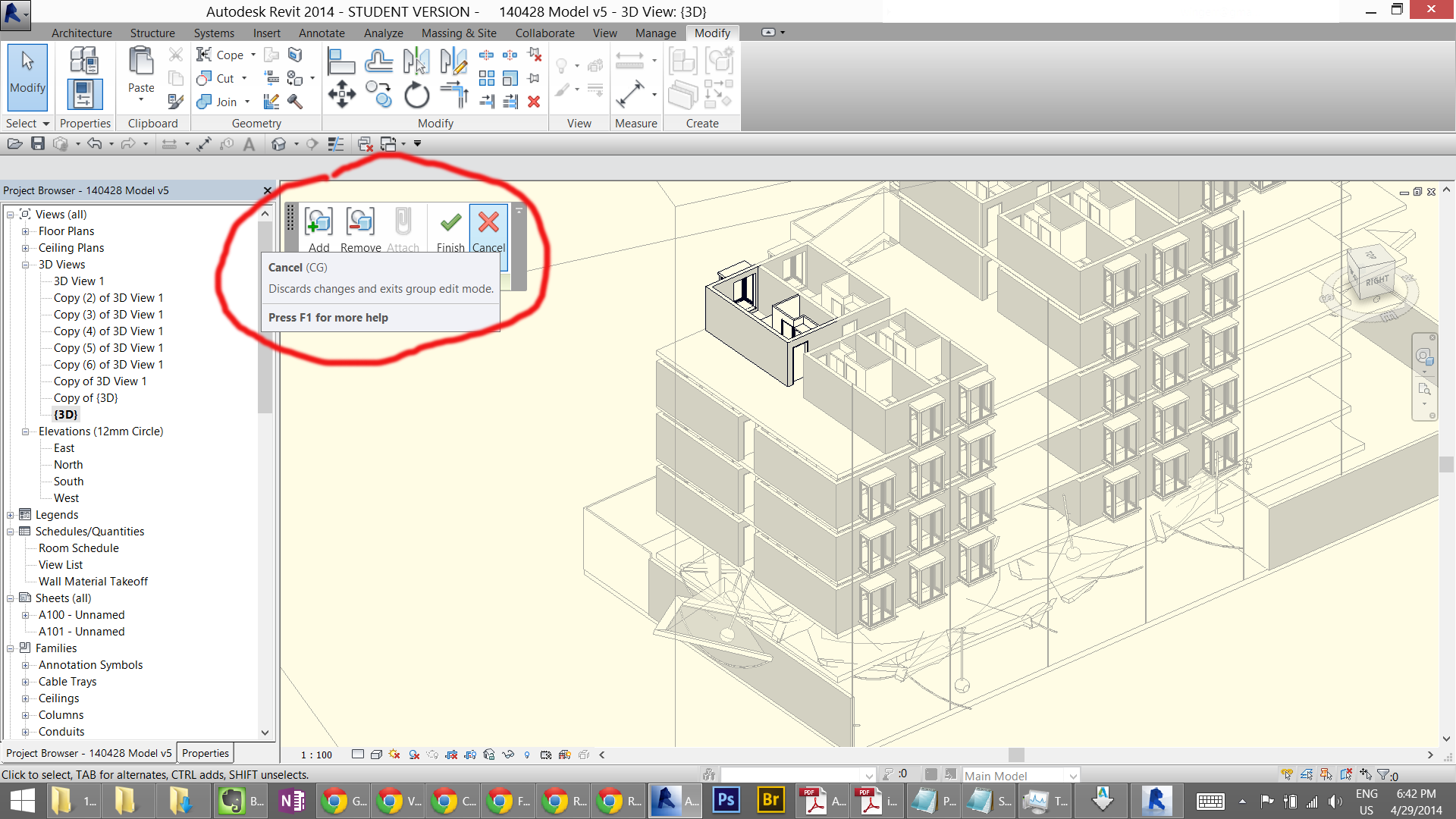

Tue, Apr 29, 2014 at 12:46:19 PM | Stuck in Yellow Screen
#9
alau1
Joined: Sat, Mar 22, 2014
0 Posts
Found this somewhere else:
"By default, the Edit Group panel is a 'torn off' panel that should be floating in the upper left corner of the drawing window. It can be "returned to Ribbon" where it will dock itself on the right side where the contextual tools will be. If you can't find it, it may be on another monitor?"
Hope that's what you are looking for!
